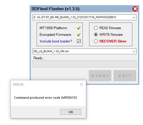

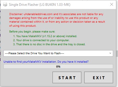

I have 2 new drives and purchased the Flash tool single drive flasher for both. Neither are seen and I get " Unable to find yourMakeMKV installation". Any suggestions would help. I was able to flash with the SDFtool but still no joy. I have included screen shots.

Failed SDFtool Flash with command procedure error Oxff05c103
OS device name: U:
Product: BD-RE BU40N
Revision: 1.02
Serial number: MOFM2QG5610
Bus encryption flags: 1F
Harware support: Yes
Firmware support: No
Firmware version: 1.02
Please help,
Scott

Re: Attempting to Flash for UHD
Reinstall makemkv to the default directory if it's not
No Change at all.
- Posts: 4900
I've emailed you already about this. I assumed it was sorted as I never heard back from you.
Can you confirm:
1. You are running Windows 10 or 11 (64 bit)
2. You are NOT using a VM
3. You installed MakeMKV in the default directory (which is C:\Program Files (x86)\MakeMKV)
Also, how are your drives connected to your PC? What enclosures or adapters are you using?

According to MakeMKV in your picture, your BU40N is at 1.03 with LibreDrive enabled. Why are you trying to flash it?moviewatcher22 wrote: ↑Sat Jan 31, 2026 2:57 amHi,
I am having this same error code, 0xff05c103
Using Win10, makemkv installed on c:, not running a VM. Any help would be appreciated.![]()
Because I don't know what I am doing. It shows up as you see but the drive does not open, the led does not light up. In MakeMKV it won't open when I hit eject. So I was thinking it needs to be flashed, it came this why from who I got it from online.
- Posts: 4900
So what drive is it?moviewatcher22 wrote: ↑Sat Jan 31, 2026 5:29 amBecause I don't know what I am doing. It shows up as you see but the drive does not open, the led does not light up. In MakeMKV it won't open when I hit eject. So I was thinking it needs to be flashed, it came this why from who I got it from online.
Make?
Model?
Manufacture date?
Then copy/paste the MakeMKV drive info & libredrive info sections.
That error code normally means there's a disc in the drive. Remove it.
