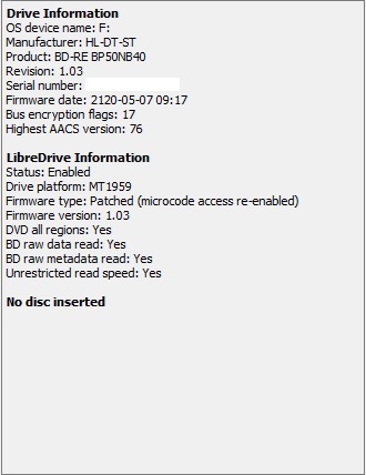

I was hoping someone might be able to help me with an issue I'm having with a drive I recently flashed. It's an HL-DT-ST BP50NB40 (NB50) in a micro-USB enclosure. I followed the guide and used the tools from here: viewtopic.php?f=16&t=22896 and got the firmware file from the all-you-need firmware pack on this post: viewtopic.php?t=19634. The drive flashed properly, as far as I can tell. There were no errors, anyway. And as you can see from the screenshot below, MakeMKV acknowledges that the drive's running patched firmware and Libredrive is enabled. However, I've tried two different UHD discs in the drive and it behaves the same as it did before flashing- it spins the disc up for several minutes but does not recognize it as anything.
Does anyone have any suggestions as to what I could try? I'm not sure what's gone wrong.

Re: Flashed UHD-Friendly Drive Still Won't Read UHD Discs.
Follow my guides flashing steps you need to go to bp60
Ugh, I can't believe I missed that.
Well, thanks Billy- the bp60nb1 firmware worked like a charm.
Thanks again for all you do~

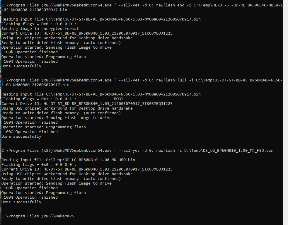

I was having the same issue thinking that I had an NB50 drive, but there was an NB52 code on the side of the box. Live and learn!
Do I need to use the command-line to flash to the HL-DT-ST-BD-RE_BP60NB10-1.02-NM00800-212005070935.bin version firmware from where I am now?

You good as is nowjtscribe wrote: ↑Sat Feb 04, 2023 7:56 pmI was having the same issue thinking that I had an NB50 drive, but there was an NB52 code on the side of the box. Live and learn!
