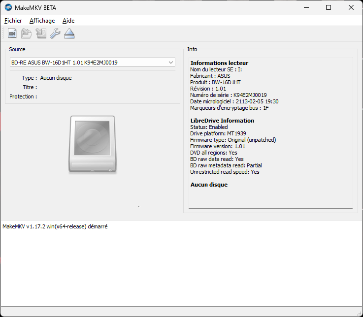

Hi, I recently bought a BD player thinking I could easily patch it, but I ran into a little problem.
The chip is an MT1939 and I understood that it needed an MT1959 (Redfox forum).
I hope I misunderstood and that the MT1939 can also be patched.
Thank you for your help.
Posts: 10900
Re: Need assistance Asus BW-16D1HT
To do anything above Bluray, you need a drive that was manufactured after 2015; your drive was manufactured 2 years before that. And the MT1939 processor locks that in place.
You can read Bluray disks with it (no patching necessary), but NOT UHD.

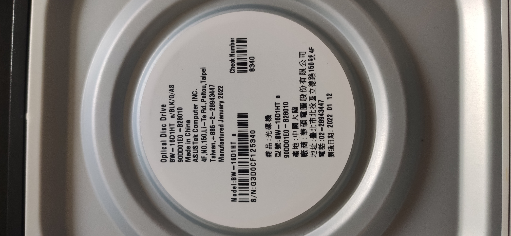

Ok, That is what I thought. The label on the reader indicates a manufacture in January 2022. :/

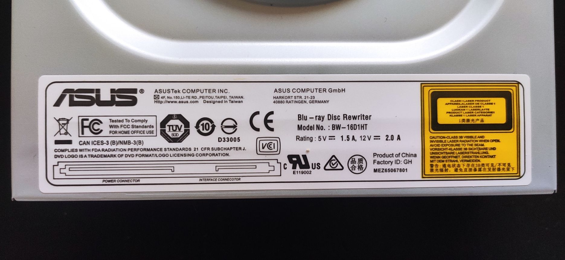

Fu2chN
Posts: 30
Joined: Wed Jan 18, 2023 5:44 pm
Post by Fu2chN »
Billycar11 wrote:
Fri Jan 20, 2023 1:15 am
Fu2chN wrote:
Thu Jan 19, 2023 9:24 pm
Let's see this sticker curious if someone out there is faking these or if it's real
Here they are.
Posts: 5731
Fu2chN wrote:
Fri Jan 20, 2023 4:15 pm
Here they are.
Hmm looks pretty real it the old style housing too compared to the LG WH16/14 XX wonder if they are going back to this because of the security flaws well may have to remove it from the list we will see in the coming weeks
Posts: 4503
Nahhhh. It's fraud.
