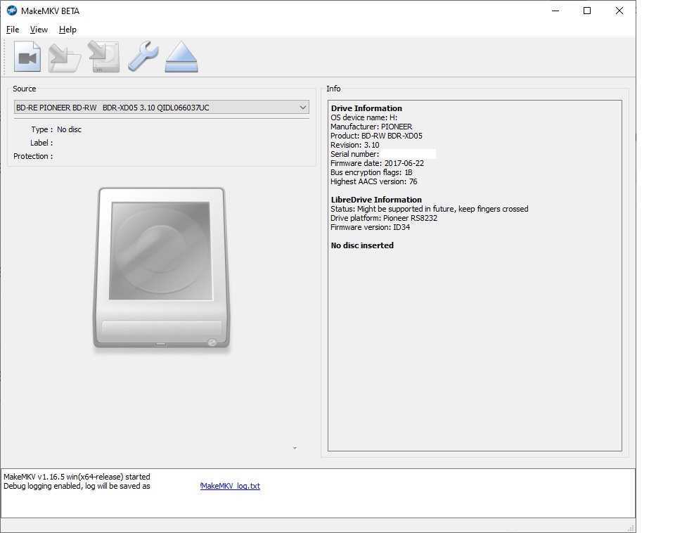

The main work to support Pioneer drives is done. MakeMKV should work with most Pioneer drives in LibreDrive mode. All drives starting from BDR-208 should be (eventually) supported, including rebranded ASUS/Optiarc/Verbatim clones.
This can be checked by drive platform:
RS1xxx - old firmware, could be technically supported, but too much hassle to make it happen. Likely would stay unsupported.
RS8000 - transitional firmware, mostly BDR-207 drives. Likely would stay unsupported.
RS8xxx and later, including RS9xxx RSAxxx and so on. Should be supported.
At the time of this writing none of the Pioneer drives require firmware update - they should just work.
If youre drive is listed above but is not supported, it means that it is not yet added to SDF.bin . Please post the drive model here.
Please do post any Pioneer specific issues in this topic.

Posts: 10961
Debug log started at Fri Feb 11 19:14:31 2022 , written by MakeMKV v1.16.5 win(x64-release)
001005:0000 MakeMKV v1.16.5 win(x64-release) started
001004:0000 Debug logging enabled, log will be saved as file://C:\Users\jeffb/MakeMKV_log.txt
Network access is ENABLED, CURL version 7.72.0/Schannel/1.41.0 (x86_64-pc-win32) , proxy server not set.
No  SDF v080: HL-DT-ST_BDDVDRW_UH08LS10_2.00_20091026123456_H9M9B395441
DEBUG: Code 3 at kx/mIn.tna?p(7TlCFJMk\o%:29395310
SDF id v080: HL-DT-ST_BDDVDRW_UH08LS10_2.00_20091026123456_H9M9B395441
No  SDF v080: Slimtype_EB1_HLE2_RIDL002570WL
SDF id v080: Slimtype_EB1_HLE2_RIDL002570WL
Not worried about the UH08LS (so very old...), but the EB1:
OS device name: G:
Manufacturer: Slimtype
Product: EB1
Revision: HLE2
Serial number: RIDL002570WL
Firmware date: 2017-04-25
Highest AACS version: 72
Status: Might be supported in future, keep fingers crossed
Drive platform: Pioneer RS8A10
Firmware version: GENE
Posts: 4653
Doesn't work with a BD-RW BDR-209D with drive platform RS8601. Discs not recognized.
Doesn't work with BD-RW BDR-211M with drive platform RS8800. Creates SCSI errors.
EDIT: Libredrive is activate for for both drives. Most likely the 209 doesn't support UHDs but the 211 supports UHDs and creates the errors.
