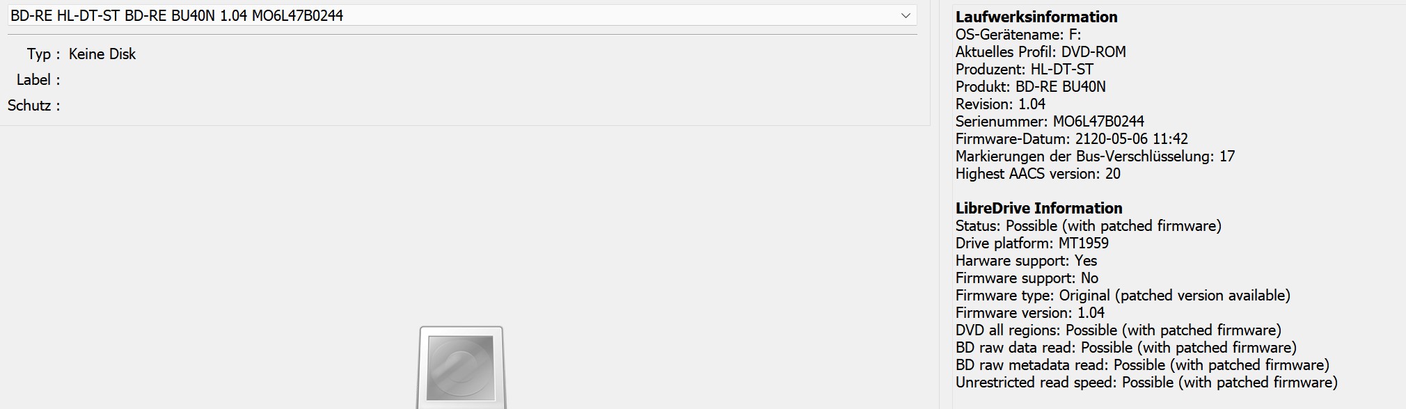

Hello guys,
my drive should be ready for libre drive - but I don't find it in the firmware download.
Which firmware should I use?
Screenshot 2022-02-02 183629.jpg (149.12 KiB) Viewed 18007 times
Thanks for your help.
Dieter

Look in the folder BU40-N-Main. Flash 1.04 MK. Then it is recommended to downgrade to 1.03 from the OLD folder.

Or just directly flash BU40N 1.03-MK from the old folder.

Bu40n 1.03 to current directly to 1.03mk
Wh/16ns40 and equivalents 1.04 to current directly to 1.04mk or WH16NS60 1.02mk as recommend
And same for WH16NS60
After they added the addition downgrade checks you can only go back to those firmwares in 1 step so for BU40N that's 1.03 for WH16NS60 it's 1.02 for WH/bh16NS40 and equivalents it's 1.04
For Asus it 3.10
There is more but you get the idea

Yeah, as Billy said but the way I like to think of it is:
BU40N_1.03-MK for slim drives and WH16NS60_1.02-MK for desktop drives are magic firmware's that can be flash to from any firmware version.
Example 1: The Buffalo, Archgon and LG BU40N, regardless of current firmware version (BU13, BN13, newly encrypted 1.02 and 1.04) can all be flashed directly to BU40N_1.03-MK. If you then want to change again, such as BU10 for Buffalo, it can then be easily flashed again.
Example 2: Any desktop drive from LG (WH14NS40, WH16NS40, BH16NS55, WH16NS60 etc), regardless of current firmware version, can all be flashed directly to WH16NS60_1.02-MK, if that is what you want to use. If you want to stick the firmware from the same model, then use the MK equivalent (or 1.04-MK of same model if no equivalent).
