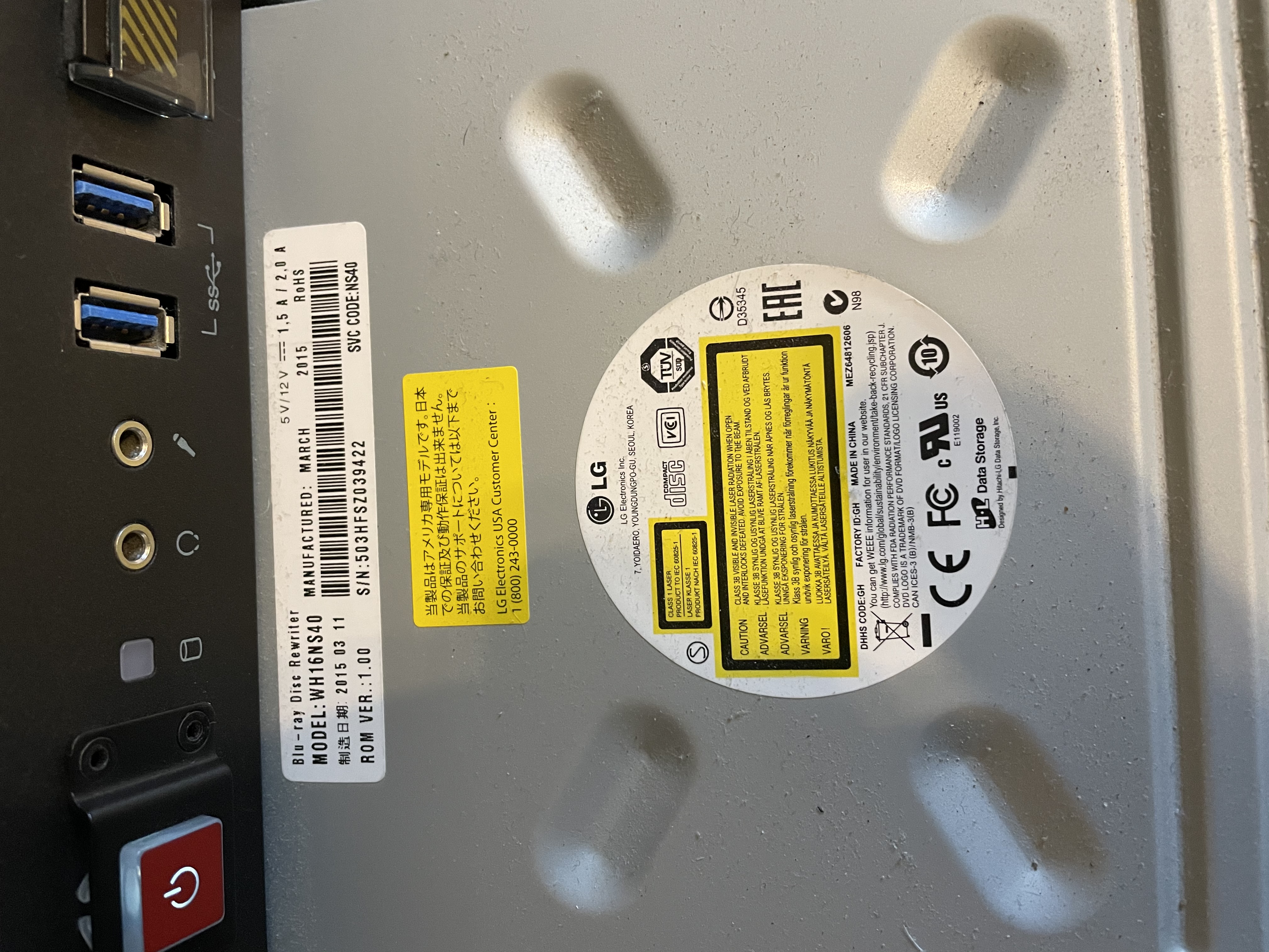

Is this too old to rip UHD disks? I haven't done anything to it yet, maybe updated the firmware way back when it was new.
OS device name: E:
Product: BD-RE WH16NS40
Revision: 1.02
Serial number: K93F3CIxxxx
Firmware date: 2114-05-07 10:26
Highest AACS version: 62
Drive platform: MT1939
Firmware version: 1.02

No, the hardware doesn't support it. Anything built prior to late 2015 isn't UHD-capable, regardless of the firmware.
