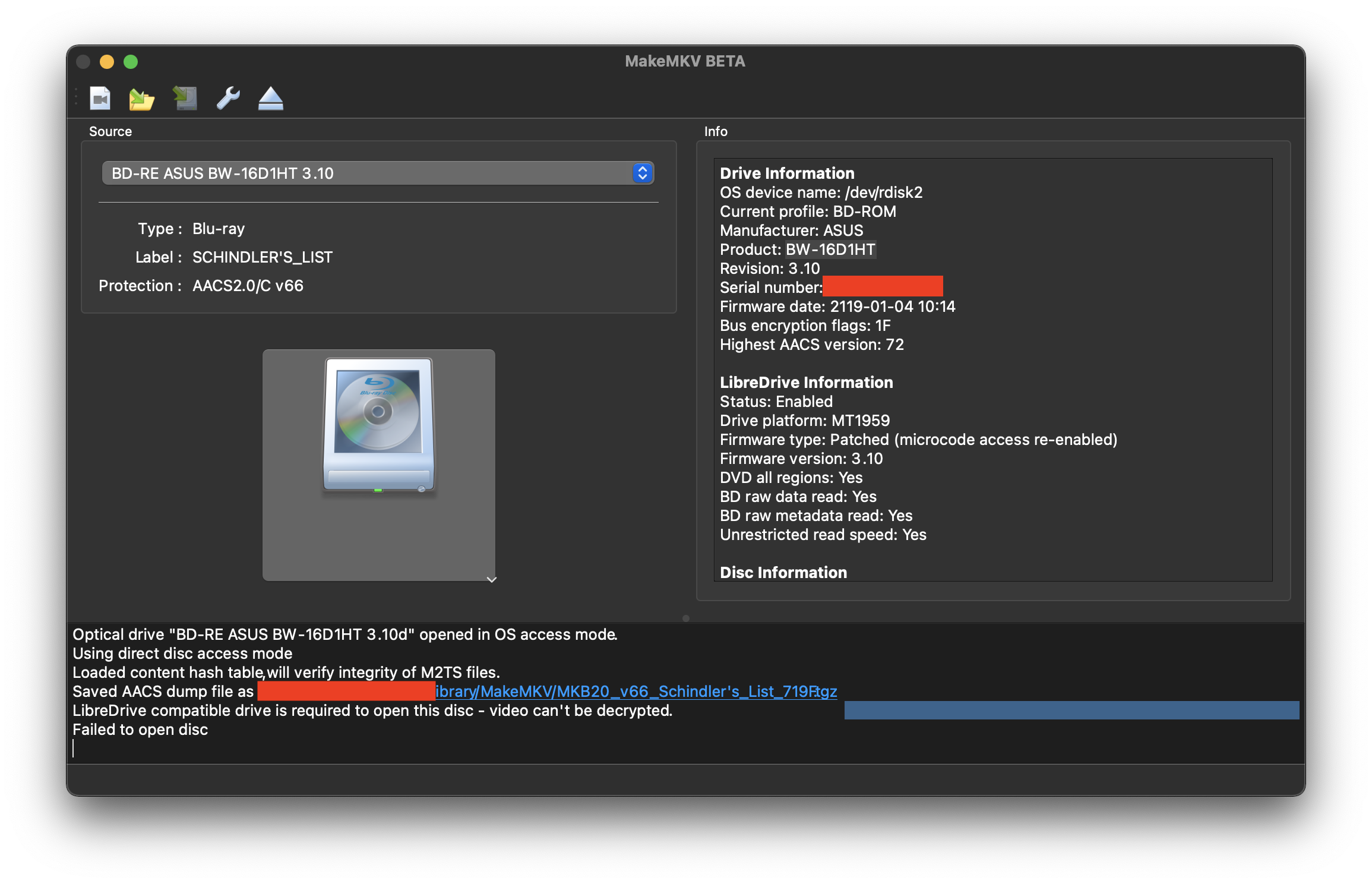

I'm trying to RIP one of my discs but I keep getting "LibreDrive compatible drive is required to open this disc - video can't be decrypted." error.
As far as I know, I already have a LibreDrive compatible driver with the right firmware. Anyone else has experienced this?
I have ripped 50 different UHD discs and this is the first time I'm getting an error.
I'll attach a screenshot of MakeMKV for reference.
- Screenshot 2021-05-20 at 15.09.07.png (615.97 KiB) Viewed 13557 times

It looks like you're using a Mac. Are you on Intel or Apple Silicon? Which OS are you on? I use a Mac. I even have an ASUS BW-16D1HT on firmware 3.10 like you. I've ripped a few dozen UHDs and never seen the error you posted. I do not have Schindler's List to try, however.
Have you updated the OS recently? Can you successfully rip a different UHD? I know you've said you have ripped them in the past… but if something changed in an OS update, can you rip now? I'm asking these questions to attempt to figure out if it is something specific to your setup or specific to that disc. On this forum, I haven't seen other posts with this error on this disc which makes me suspect it is something in your specific setup. A little testing might help narrow it down.

Hey, thanks for you reply!dcoke22 wrote: ↑Fri May 21, 2021 1:50 pmIt looks like you're using a Mac. Are you on Intel or Apple Silicon? Which OS are you on? I use a Mac. I even have an ASUS BW-16D1HT on firmware 3.10 like you. I've ripped a few dozen UHDs and never seen the error you posted. I do not have Schindler's List to try, however.
I’ve tested on both Intel and M1 machines, same problem. I’m on latest 11.3 OS update on both.
I just tested with my old UHD discs, about 10 of them, and they all worked.
After some googling, I suspect that they keys haven’t been generated perhaps? And maybe the error message is just broken?
I’ve sent the file to svq@makemkv.com, I’ll try to rip the disc again in a few days and see if that solves the problem.
Other than that I don’t know what could be the issue, I’ve tested on multiple computers, multiple different SATA cables and nothing has solved the issue.
