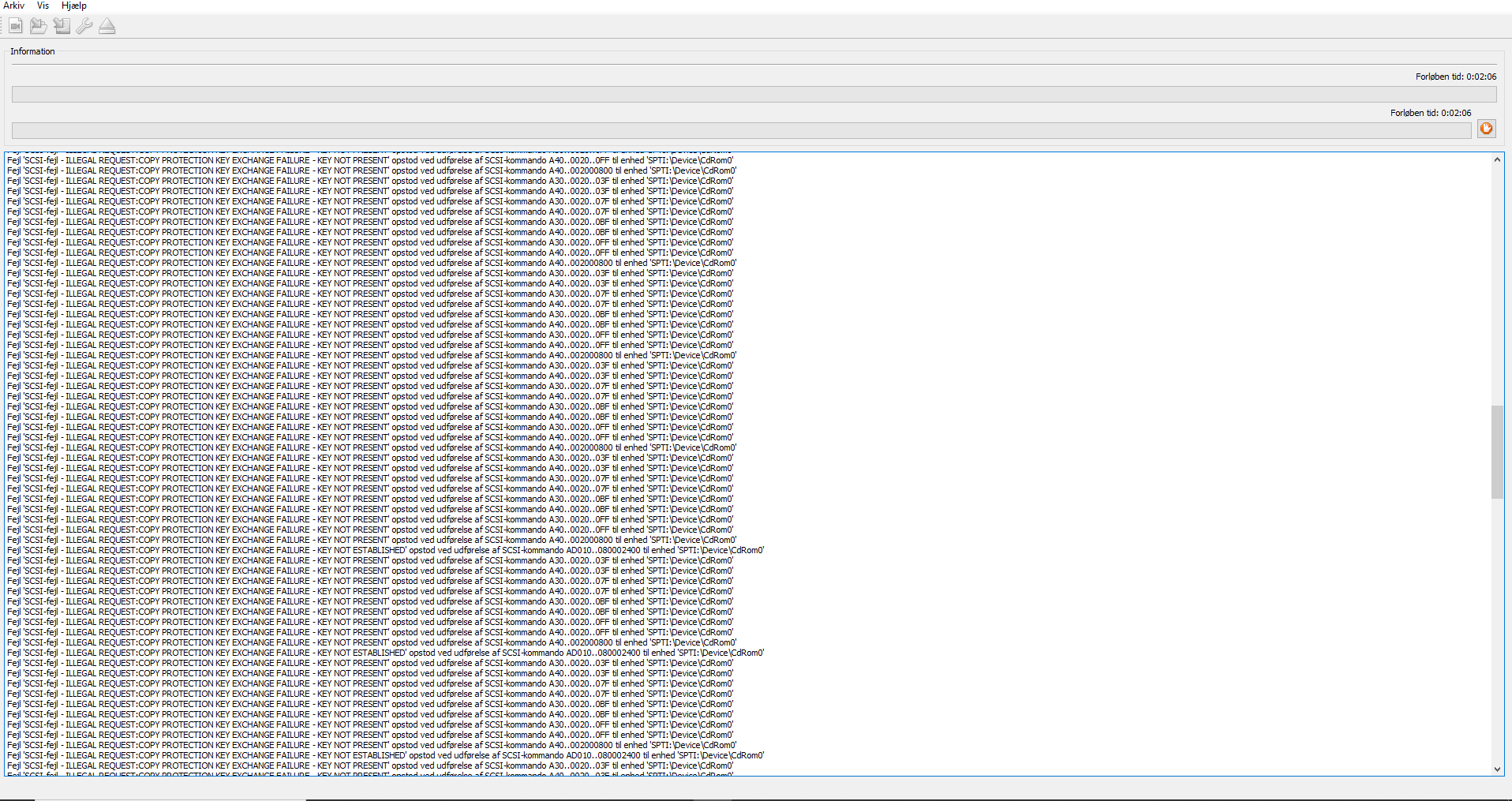

I bought this LG BU40N Slim Drive + Vantec Enclosure from one of the recommended sellers in the forum. It should be plug and play ready.
However I get this error report when I try to backup an UHD disc as you can see in the attachment.
I also get an error when trying to backup a normal bluray disc.
Any thoughts on this will be highly appreciated.

your second picture does not show it but im 99% sure up in top of the log it says hardware timeout on logical unit
drive needs more power use both plugs and or a high powered usb Hub like this: https://smile.amazon.com/gp/product/B00 ... UTF8&psc=1

not always but for usb drives thats what it normal means in my experience.
because when drive does not have enough power it reboots and makemkv says its taking to long to respond.
it then boots back up and mkvmkv think LD is still loaded in the ram but its not because of reboot
and you get a bunch of illegal key exchange errors because of it.

Thank you very much Billy. It worked with both usbs plugged in.

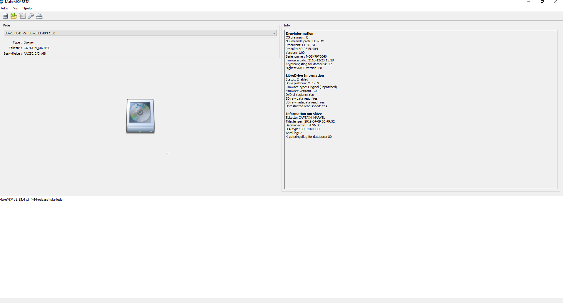

Just want to point out to the OP, your drive is NOT Libre Patched!

No it is stop talking about something you don't know about
You can see they say it works once they plugged in both cables

Excuse me? Look at the first pic it clearly states unpatched.

It also clearly states "Status: Enabled" w/ the accompanying 4 - "Yes"s. No need to patch.

Unless I misread, Mike also says so. LibreDrive firmware status
See section "supported - original vendor firmware: 68 firmware(s):"
HL-DT-ST-BD-RE_BU40N-1.00-N003103-211612201528
But MakeMKV's word is usually good enough for me.

i guess if the OP wants to run really old firmware then sure, i prefer to use more current firmware as i find 1.02 way more stable for ripping
