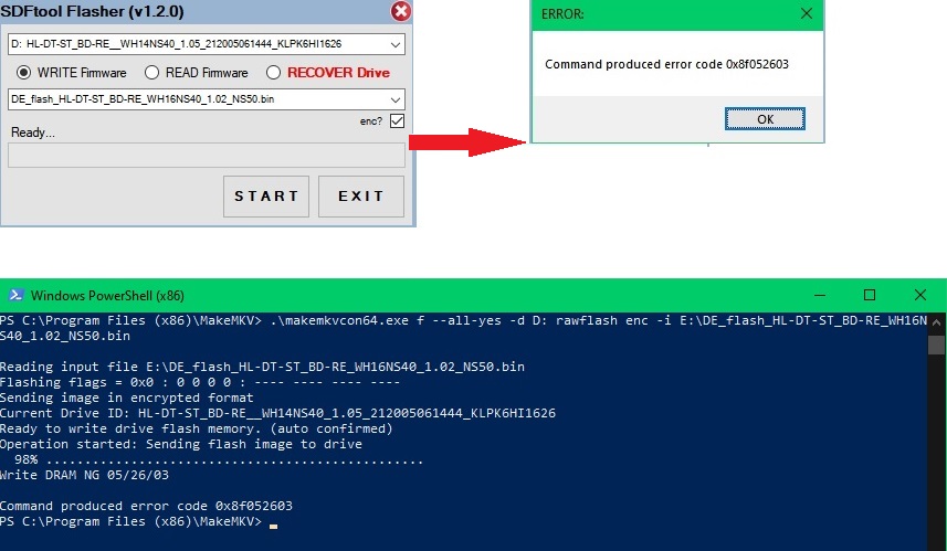

I keep getting this error code both when using the GUI SDFtool Flasher v1.2.0 or the command line makemkvcon64.exe tool to try to flash my new drive. See the screenshots below. What am I doing wrong?
As you can tell I'm a noob. I just want to be able to rip BDs into MKV files so I can watch them on all my devices. UHD isn't necessarily a big priority since my BDs will mostly be HD. Thanks in advance for any help.

flash to WH16NS60 1.02mk like my guide says i made it for a reason to avoid issues like this
Posts: 4780
Re: WH14NS40 1.05 error code 0x8f05c603
Also his stock firmware is encrypted, so use the "enc" option.
Posts: 4464
The guide is here: viewtopic.php?f=16&t=19634
It is a sticky post at the top of the UHD drives section. Your drive is new enough that it has an encrypted firmware which makes it harder to downgrade.
Posts: 4780
@Shozo,
You were also trying to flash the WH16NS40 1.02 firmware instead of the WH14NS40 1.05 firmware. When your drive has an encrypted firmware, you really need to flash the equivalent MK firmware first.
So, since your drive has 1.05 on it, you should flash WH14NS40 1.05 MK from the MK firmware pack first using the "enc" option. After this flash, you can then flash the drive to whatever firmware you want to use.
Posts: 5545
he already had the enc option on in both sdf tool and cmd so i just said the firmware thing thats all thats wrong

Thanks for all the help. I was able to successfully flash to WH14NS40 1.05 MK from the MK firmware pack.
So from here, will this MK version of the stock firmware allow me to rip BDs to MKV, or should I now flash to WH16NS60 1.02mk? And when I do this, I should leave "enc" unchecked right?
