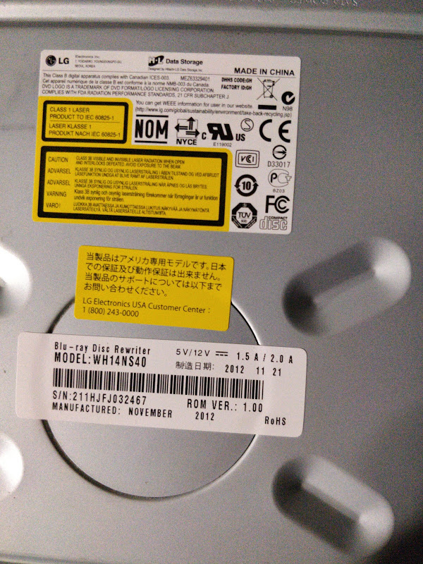

Hello! I recently bought a used WH14NS40 (Manufactured Nov. 2012, had firmware v1.00, info label pic attached)
I foolishly flashed the WH14NS40-NS50 firmware (linux):
# sdftool -d /dev/sr0 rawflash -i /tmp/HL-DT-ST-BD-RE_WH14NS40-NS50-1.05-NM00900-212005061444.bin
That, of course, soft bricked the drive. After doing more research, I found the patched flasher guide, and in Windows crossflashed WH16NS60 1.02 (as recommended here)
That flashed successfully, but after rebooting, the drive wasn't able to read discs, saying "No disc inserted" in MakeMKV
After more toying around I decided to install the latest official firmware (v1.03), using the patched flasher, extracting the .bin from the official installer with Firmware Extractor 2. That flashed succesfully, but I'm still left with the drive not recognizing discs (DVDs and Blu Rays).

Is there any hope for this drive? I'll probably be getting another drive that's actually UHD friendly (this version number was deceiving), but it'd be nice to be able to resell this one in working condition. Any help is much appreciated :)
Drive info label
Drive info label
drive info.jpg (219.56 KiB) Viewed 10258 times
