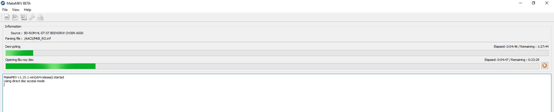

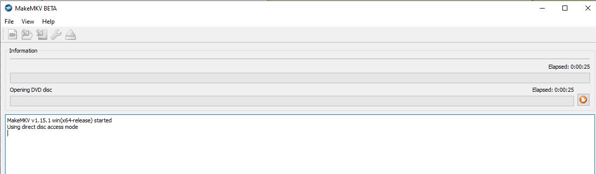

Make MKV was working flawlessly until today when all of a sudden it won't rip Blu-rays or DVD's. It knows there's a drive there, but won't go much further than the beginning. See screenshots for where it stops.
- Capture.JPG (43.59 KiB) Viewed 70686 times
- Capture1.JPG (50.91 KiB) Viewed 70686 times

Please try to disconnect and reconnect the drive, could be a glitch caused by LibreDrive update. If nothing changes, please post (or send) the log file.

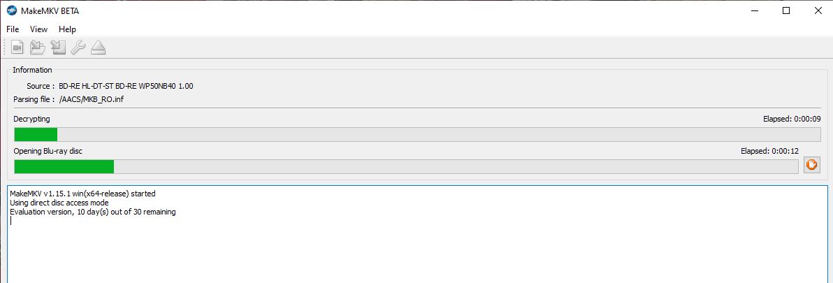

Got the same issue here today. Hangs on the RO.inf both on Bluray and UHD discs and computer does not shut down any more properly.

- Capture1.JPG (61.16 KiB) Viewed 70533 times

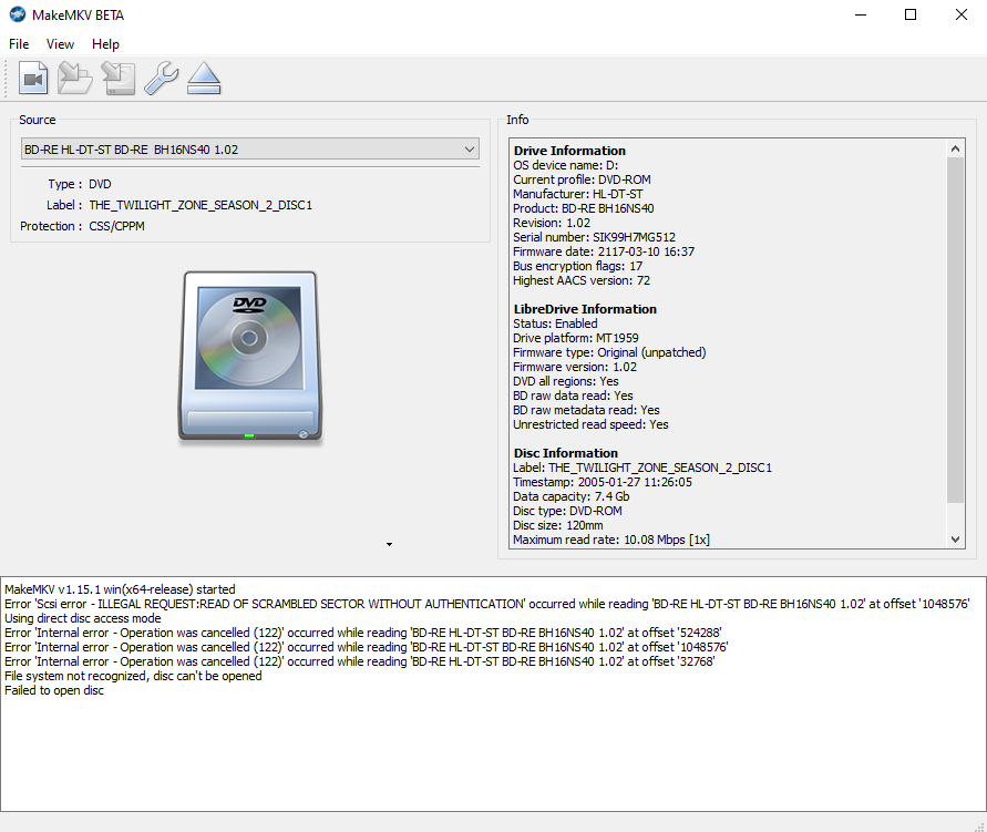

Wanted to report that I too am seeing the same issues as OP that started very recently. I used it a few days ago without issue, then when attempting to use it today ran into it. While ripping BD's (same error message and everything).
I am also having the issue with DVD's during the decrypt step, however with a different error message. I've attached a screenshot with the error message as well as the model of drive etc. It's an external drive so I have tried cycling the drive itself for 5 seconds; I have also tried a reboot of the machine just to be sure. The issue persists after both. I am running Windows 10 Pro version 1909, any assistance would be appreciated!
- Error message for DVD along with drive info.
- makeMVK_disk_open_error.PNG (89.08 KiB) Viewed 70531 times

Re: BD Drive won't rip DVD or Blu-rays all of a sudden
Hi, Same issues here.
Auto updated the sdf and now every time it try's to read a DVD or Blu-ray the computers freezes for 5 min then multiple errors on makemkv with drive not available.
A restart/shutdown will make the drive available again.
OS device name: L:
Product: BD-RE BH16NS40
Revision: 1.03
Serial number: K9UF4BE4305
Firmware date: 2114-03-26 11:15
Highest AACS version: 14
Drive platform: MT1939
Firmware version: 1.03
BD raw metadata read: Partial
Unrestricted read speed: Yes- Attachments
- MakeMKV_log.txt
- (57.65 KiB) Downloaded 4374 times
