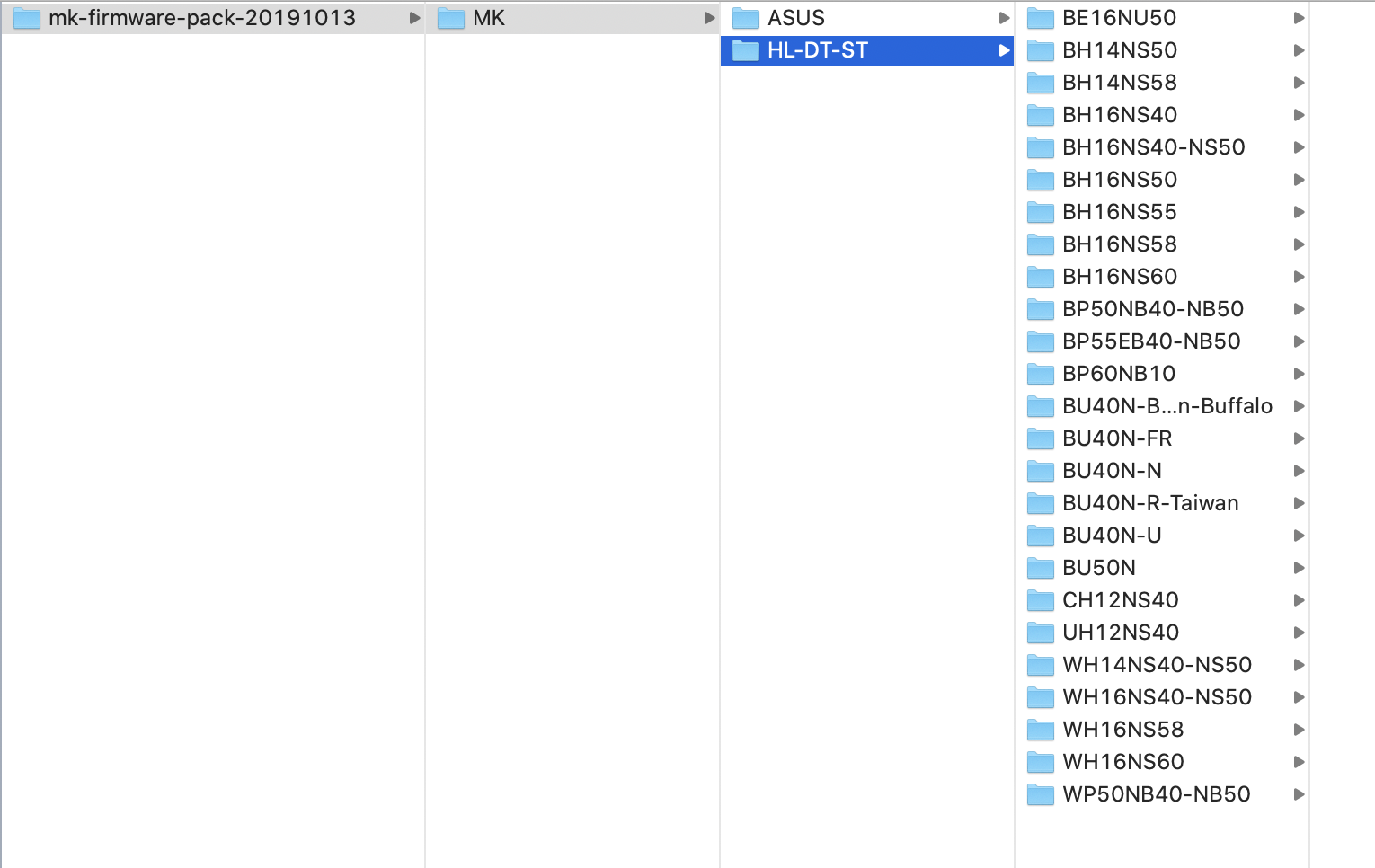

Re: Enable LibreDrive
Posted: Tue Nov 19, 2019 12:48 am
by bigozbear
OS device name: /dev/rdisk9
Manufacturer: BUFFALO
Product: Optical Drive
Revision: BN10
Serial number: KZ8H92J1011
Firmware date: 2117-05-30 17:24
Bus encryption flags: 1F
Highest AACS version: 68
Screenshot 2019-11-19 at 00.45.45.png (182.2 KiB) Viewed 71417 times
Screenshot 2019-11-19 at 00.46.19.png (236.77 KiB) Viewed 71417 times
Where do I find the firmware for my BUFFALO drive?
My drive (information via MakeMKV) says "Possible, Not Yet Installed"
I downloaded file: mk-firmware-pack-20191013
/MK/ASUS --- /HL-DT-ST
Posted: Tue Nov 19, 2019 3:19 am
by MartyMcNuts
Revision: BN10
What model drive is it?
