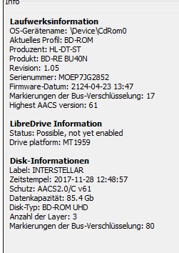

I bought a Verbatim 43888 UHD Drive and I thought I could just connect it to the PC and start using MakeMKV to store my discs onto my NAS System.. Now I read about the LibreDrive topic and that I need to flash the firmware.
Honestly, I do not know what exactly I need to download and what I need to do, in order to make it work. Anyone here who could guide me through that process?
This is the Information from MKV about my drive if that helps.
MakeMKV Info.jpg (42.97 KiB) Viewed 658 times

see guide below or
email me or marty for an autoflasher
