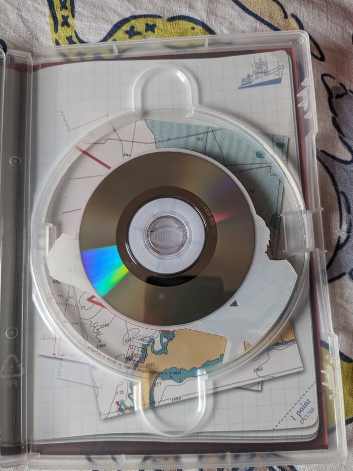

It is a DVD boxset set of Jacques Cousteau's Ocean Tales from Citel Video in France, and stated as DVDs on the back covers.
The disc itself is really unusual though, I have never seen this mix of disc before.

That looks like a 8 cm DVD that would fit into the smaller circle of a tray loading optical drive or onto the spindle of a mobile optical drive. But you said it won't fit?
Being from France it'll be Region 2.

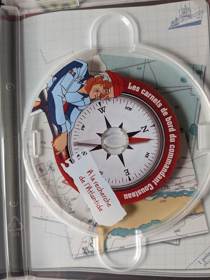

The full size section is clear on the back, which can be confusing, a photo of the other side:
- PXL_20240403_020727244.jpg (94.05 KiB) Viewed 9056 times
