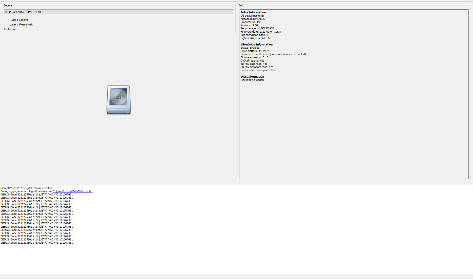

I have a Asus BW-16D1HT and have never had any issues with it. About a month ago I took a break from ripping bluerays and dvds and when I tried to start back up again I ran into some issues. MakeMKV takes FOREVER to recognize a disk assuming that it even does. During that time I have gotten then following debug codes:
DEBUG: Code 3221225861 at SnjLlET?7*kAC=V3:121267431
DEBUG: Code 3221225861 at 266L9_:?HCenQ;[b:213134952
If it successfully recognizes the disk then there is about a 25% change that I can get all the way through ripping (I haven't gotten it to read a disk recently in order to get an error code/message). The only change that has occurred in that month that I think could affect it would be updating from MakeMKV 1.15.1 to 1.15.2 however even downgrading doesn't seem to resolve the issue. Any help would be greatly appreciated! Thanks for your time
- Debug.PNG (82.32 KiB) Viewed 49806 times

I am incredibly frustrated as this is one of my favorite movies (Repo! The Genetic Opera) and I am certainly not thrilled that I cannot rip it.
I've gone through the rest of my BluRay collection and all (except 4K) discs will read & rip. I did all my ripping alphabetically, so I had ripped 30+ BluRays after trying to rip Repo, all without issue.
I'm curious if anyone else has had a similar (only specific discs cannot be read) issue or not.
I'm going to try doing this task in Linux, to see if the result is any different, and I'll report back.
I've been trying to read/rip it for the past few years. I've gone from the original firmware that shipped with the drive, to the latest 3.10. If memory serves, I was using MakeMKV 1.14.x but am now on the latest 1.16.5 - and I've been pretty consistent about upgrading my version every 2 or 3 minor release versions.
- Posts: 5862
Re: Asus BW-16D1HT stoped reading disks suddenly
Clean the discThatOneGuy wrote: Fri Dec 03, 2021 2:25 pm Needless to say, I have the same optical drive. But my issue is isolated - only 1 standard BluRay disc cannot be read/recognized.
Replace the disc
I've experienced this with some 4K blu rays too. I'd suggest;ThatOneGuy wrote: Fri Dec 03, 2021 2:25 pm I'm curious if anyone else has had a similar (only specific discs cannot be read) issue or not.
- Remove the disc
- Restart the computer
- Open MakeMKV, insert the disk
- As soon as the disc is recognised, rip the entire disc to a folder using the 'Make Backup' option
- You can then create an MKV from the backup folder, not the disc
I'm not exactly sure why this works but I suspect there is some kind of timeout issue or the decryption process glitches during the creation of the MKV directly from the disc. I'd be interested to hear if this helps. Sometimes you might need to repeat the whole process a couple of times to get success.
