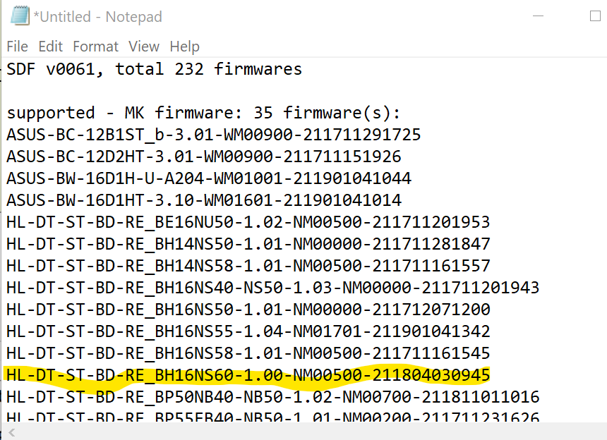

I just installed my new UHD Bluray drive: a Hitachi/LG BH16NS60 with firmware version 1.00 and date as listed in the supported LibreDrive firmware list on the thread here at this forum.
supported frimwares.png (68.11 KiB) Viewed 15153 times

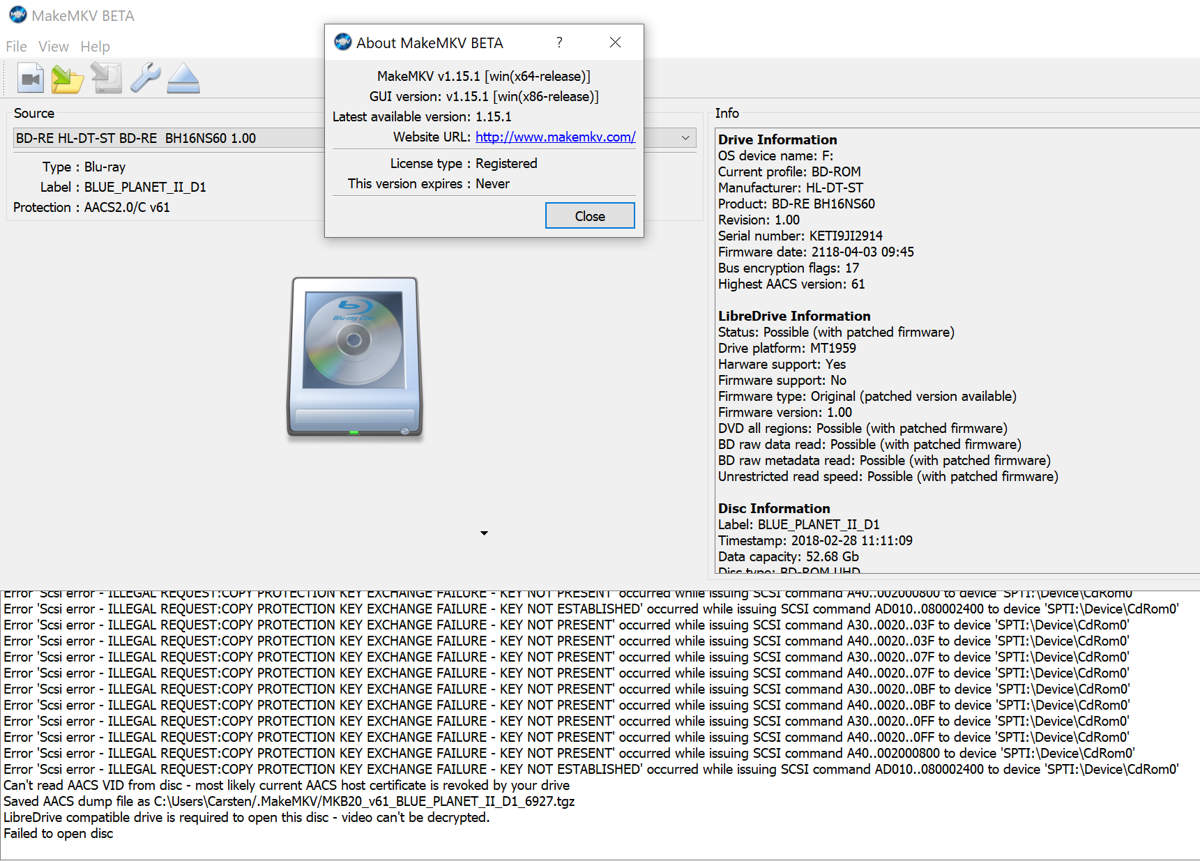

However MakeMKV fails to rip the UHD disc with these messages and info (in attached screenshot).
What is wrong?
As I read from the blog post about LibreDrive, makeMKV should be able to rip from this drive with no problems...?

ah so I've misunderstood?
LibreDrive is not available...yet?
And there is nothing I can do but wait?
And no - the drive's firmware hasn't been flashed - but it shouldn't need to either?

Ok so did some more research it seems that I need to flash the drive with MKV's firmware (MK).
I have downloaded the firmware .bin but I cannot find a flasher.
The polish one in this link :
https://forum.cdrinfo.pl/f29/crossflash ... s58-96313/
which seems to be the recommended one, seems to be unavailable.
So where do I get a flasher that can flash my drive with the MK firmware (I'm on windows 10 64-bit)?
cjohs
Joined: Thu Apr 16, 2020 6:09 pm
Re: Hitachi drive BH16NS60 on LibreDrive positive list fails
Post by cjohs » Fri Apr 17, 2020 7:50 am
After some more research I found a flasher that worked for me here:
https://drive.google.com/file/d/102V7DU ... meZTN/view
The firmware included in that download were not used.
I used the "original" one that matched my drive from this site here:
https://www.makemkv.com/forum/viewtopic ... 113#p71880
This so others looking for a solution can have one :D
My drive is happily ripping my UHD bluray for my Plex now - I will probably have to look into more storage now as those mkv files are huge :shock:
