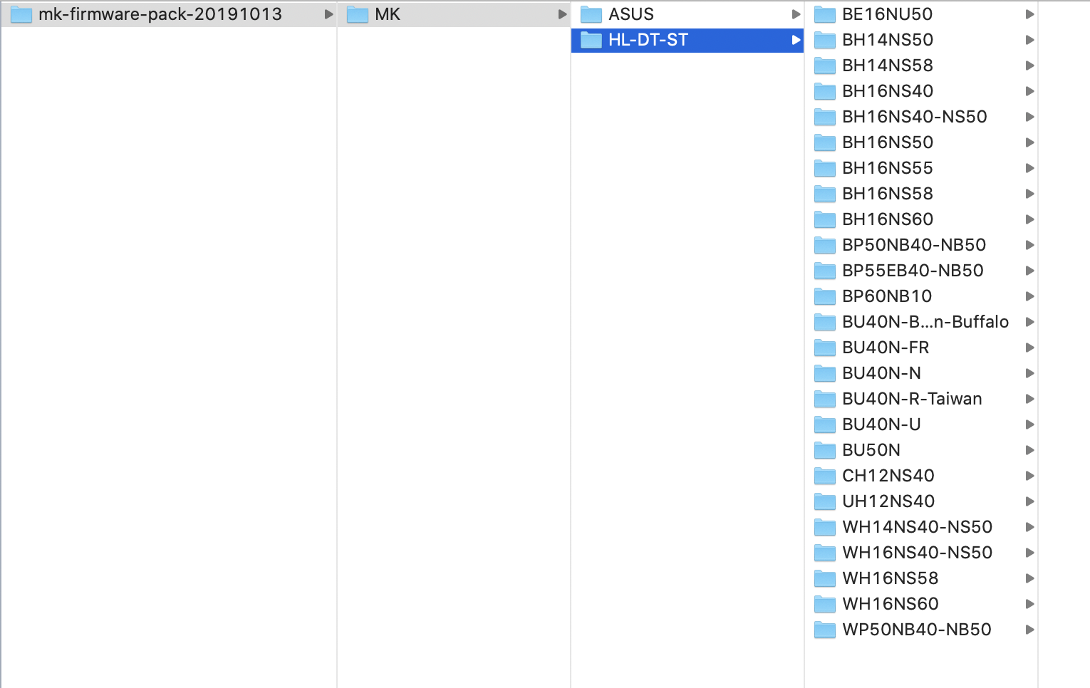

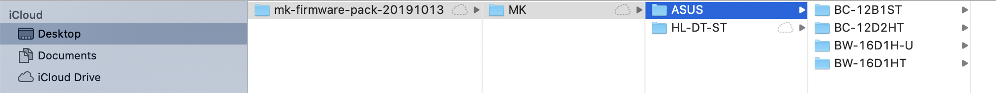

Where do I find the firmware for my BUFFALO drive?
My drive (information via MakeMKV) says "Possible, Not Yet Installed"
I downloaded file: mk-firmware-pack-20191013
/MK/ASUS --- /HL-DT-ST
- Posts: 4900
Re: Enable LibreDrive
What model drive is it?bigozbear wrote: ↑Tue Nov 19, 2019 12:48 amDrive Information
