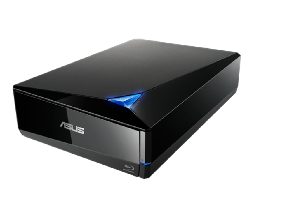

However, there is a problem with the ASUS DW-16D1X-U external Blu-ray purchased secondhand this time
If you look at MakeMKV information, it's a drive platform: RS8F00
Usually, there are two models, LG and non LG
I can't flash it because it's not from LG
No valid firmware found in firmware pack
I'd appreciate it if anyone could flush or help me with a product like me
MakeMKV
OS device name: G:
Manufacturer: ASUS
Product: BW-16D1X-U
Revision: E113
Serial number: DIDL*****
Firmware date: 2020-07-21
Highest AACS version: 60
Drive platform: RS8F00
Firmware version: E113/ID76
ASUS BW-16D1X-U help me

You are lucky! Your ASUS contains a Pioneer drive. Billycar11 can flash it for you. Just email him.

sure email me that info and all others email me no need to post your info here just reach out to me directly for pioneersmafiaboy2 wrote: ↑Sun Mar 29, 2026 12:43 amHello.
