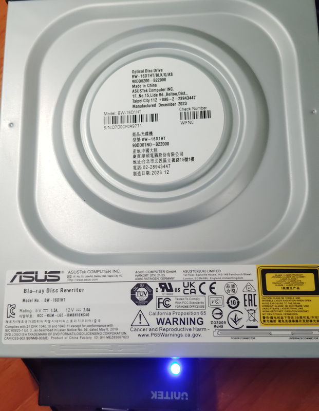

These "a" drives as well as other drives from China seem to often (but not always) be the JB7-board (MT1939) even if the date on the sticker is >=2016. Here is an example of a BW-16D1HT from China that was manufactured December 2023 and yet is JB7/MT1939:
You can recognise these drives by looking at the casing around the label, for the JB7 board there is a rounded square indent around the entire label where the JB8 has four small diagonal indents around the label.
- Posts: 5831
Re: ASUS BW-12B1ST a
But it's not made in 2023 it's re stickered they stopped making those in 2015RibShark wrote: Mon Jan 26, 2026 1:00 pm These "a" drives as well as other drives from China seem to often (but not always) be the JB7-board (MT1939) even if the date on the sticker is >=2016. Here is an example of a BW-16D1HT from China that was manufactured December 2023 and yet is JB7/MT1939:
The pre-2016 JB7s use the same casing as the JB8 drives, this new casing that is seen on these 2023-dated JB7 drives suggests they are new, and I doubt the effort would be taken to resticker a whole bunch of drives. Perhaps they found some leftover boards they needed to use up?Billycar11 wrote: Mon Jan 26, 2026 2:47 pm But it's not made in 2023 it's re stickered they stopped making those in 2015
- Posts: 5831
Officially production stopped of mt1939 drives in 2015RibShark wrote: Mon Jan 26, 2026 5:41 pmThe pre-2016 JB7s use the same casing as the JB8 drives, this new casing that is seen on these 2023-dated JB7 drives suggests they are new, and I doubt the effort would be taken to resticker a whole bunch of drives. Perhaps they found some leftover boards they needed to use up?Billycar11 wrote: Mon Jan 26, 2026 2:47 pm But it's not made in 2023 it's re stickered they stopped making those in 2015
I think they are just recasing them not sure why I guess to sell used stuff as new
The Chinese take a DVD case and put in a BDR drive of unknown quality. These aren't new drives, they're essentially fakesRibShark wrote: Mon Jan 26, 2026 5:41 pm this new casing that is seen on these 2023-dated JB7 drives suggests they are new
