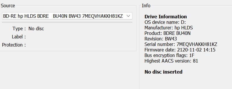

i don't know where and how to get the drive info from libredrive but here's the screenshot from MakeMKV i read the thread in this link of yours:
https://www.reddit.com/r/makemkv/commen ... b_fw_bw42/
in contrast to the user in that thread my PC won't continue flashing unfortunately. Neither with the SDFtool Flasher (v1.3.5) nor the old sdftool_flasher.exe

Based on this topic, I'd bet the enclosure is the issue. Was that you? It looks to report an LG FW, but the flash tool reports "... not a supported platform"
The guide recommends a few... but I was under the impression that most would now work?
