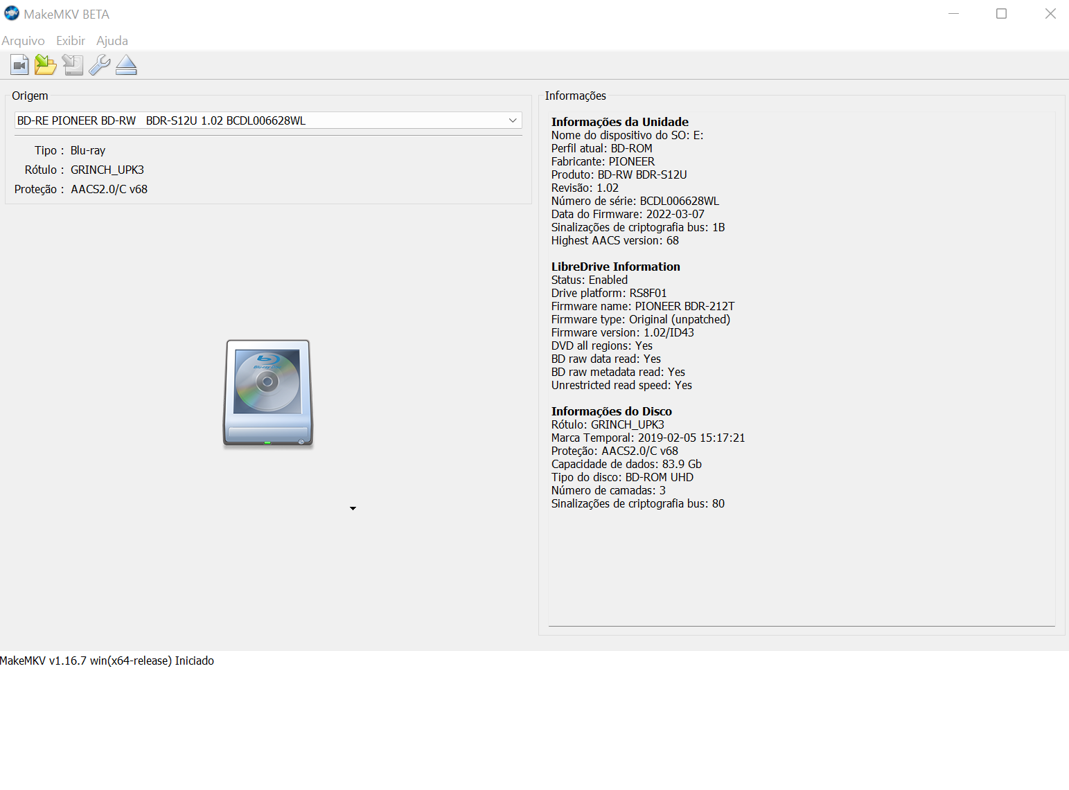

Pioneer BDR-S12UHT Firmware 1.02
Captura de ecrã 2022-05-26 225933.png (107.98 KiB) Viewed 33112 times

Can update to 1.02, Not UHD frendely but can rip blurays

You should be able to rip UHD with that

Yes. With makenkv i can.

I have FW 1.01 on my BDR-S12U.
Weren't you afraid to lose UHD rip capabilities when updating? And may I ask how you did that?

You will never lose UHD rip capabilities because the new firmware adds only few improvements
while the libredrive mode is running in RAM (firmware is not overwritten).

well i just got burned by this post. Went to 1.04 firmware and lost libre. Two brand new never used drives.

Mike the developer said few weeks for a fix
A fix will come. Keep your drives safe.

Hi, any updates on this? It's been a few months. It's showing the following for my BDR-S12UHT:
Drive platform: Pioneer RS8F01
Firmware version: ID43

Show the whole status information. If your firmware date is Dec. 2022 or later you have to wait.
