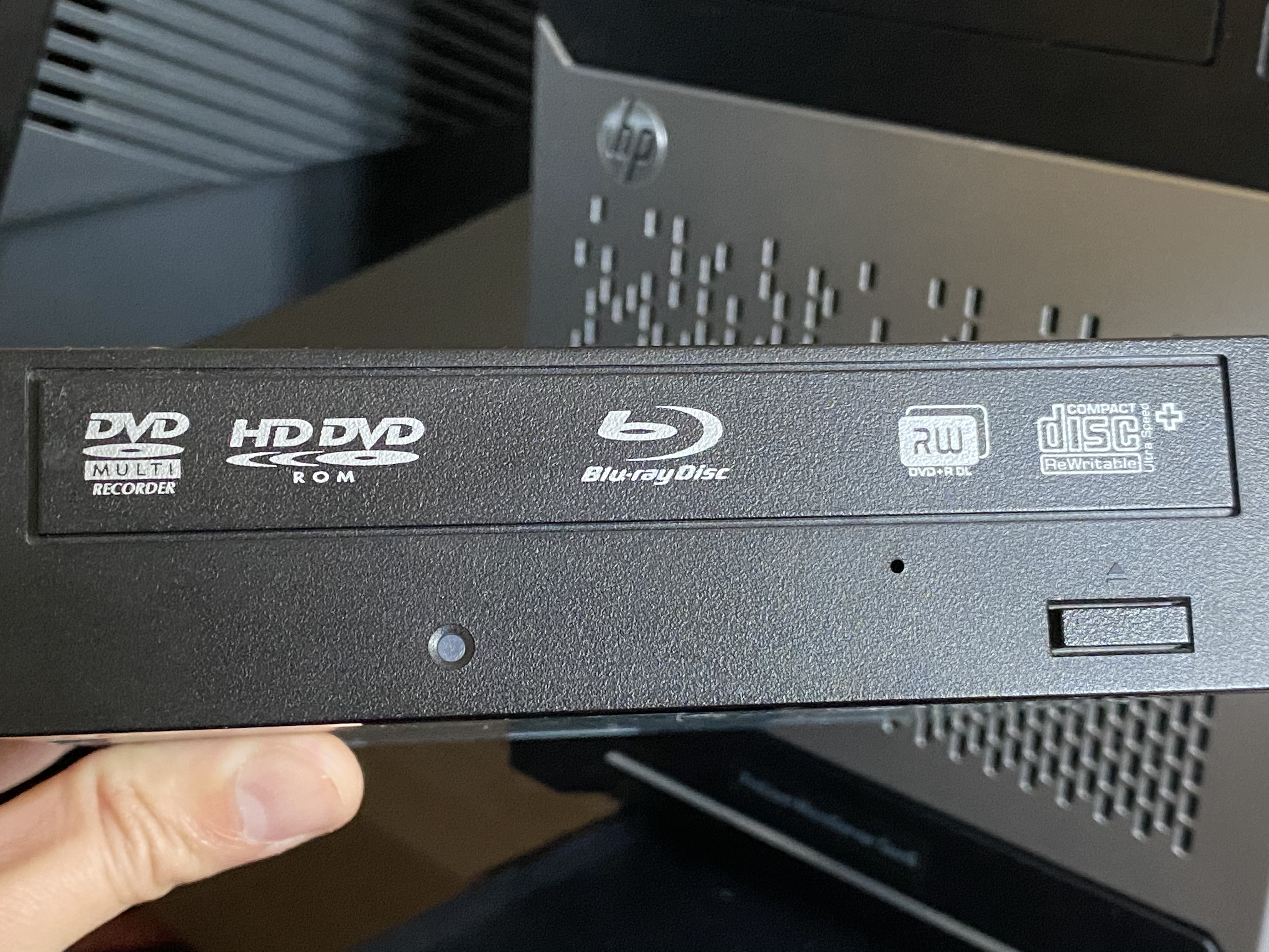

I had no clue these are HD-DVD combo drives... This makes more sense to look at then.
Yeah, there are a few logos on the front. :lol:

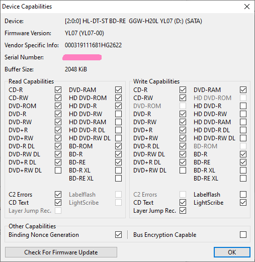

Which tool are you using that shows all the device capabilities? I have three of these drives (GGW-H20Ls), love them. Wonder if it's possible to add BDXL capability to them?
icourt
Posts: 39
Joined: Fri Jun 19, 2020 6:27 pm
Re: My poor ancient HD-DVD/BD Combo!
#11 Post by icourt » Mon Jun 22, 2020 4:34 pm
mercennarius wrote: Mon Jun 22, 2020 3:32 pm Which tool are you using that shows all the device capabilities? I have three of these drives (GGW-H20Ls), love them. Wonder if it's possible to add BDXL capability to them?
ImgBurn. Select any of the disc operations, then from the top menu, Tools > Drive > Capabilities.
I’d be very surprised if BD XL capability could be added, I don’t think the hardware would support it. They are great drives though. :)
