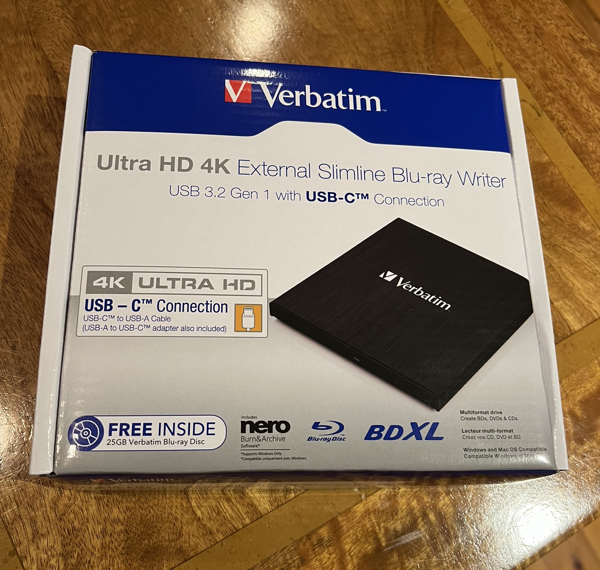

Im surprised about that too but its definitely a verbatim. Sold and shipped from Amazon AU. Looks like verbatim may have switched suppliers?
- FF08122B-7F29-4F92-ACDD-A2E73FE882A1.jpeg (1.77 MiB) Viewed 42931 times

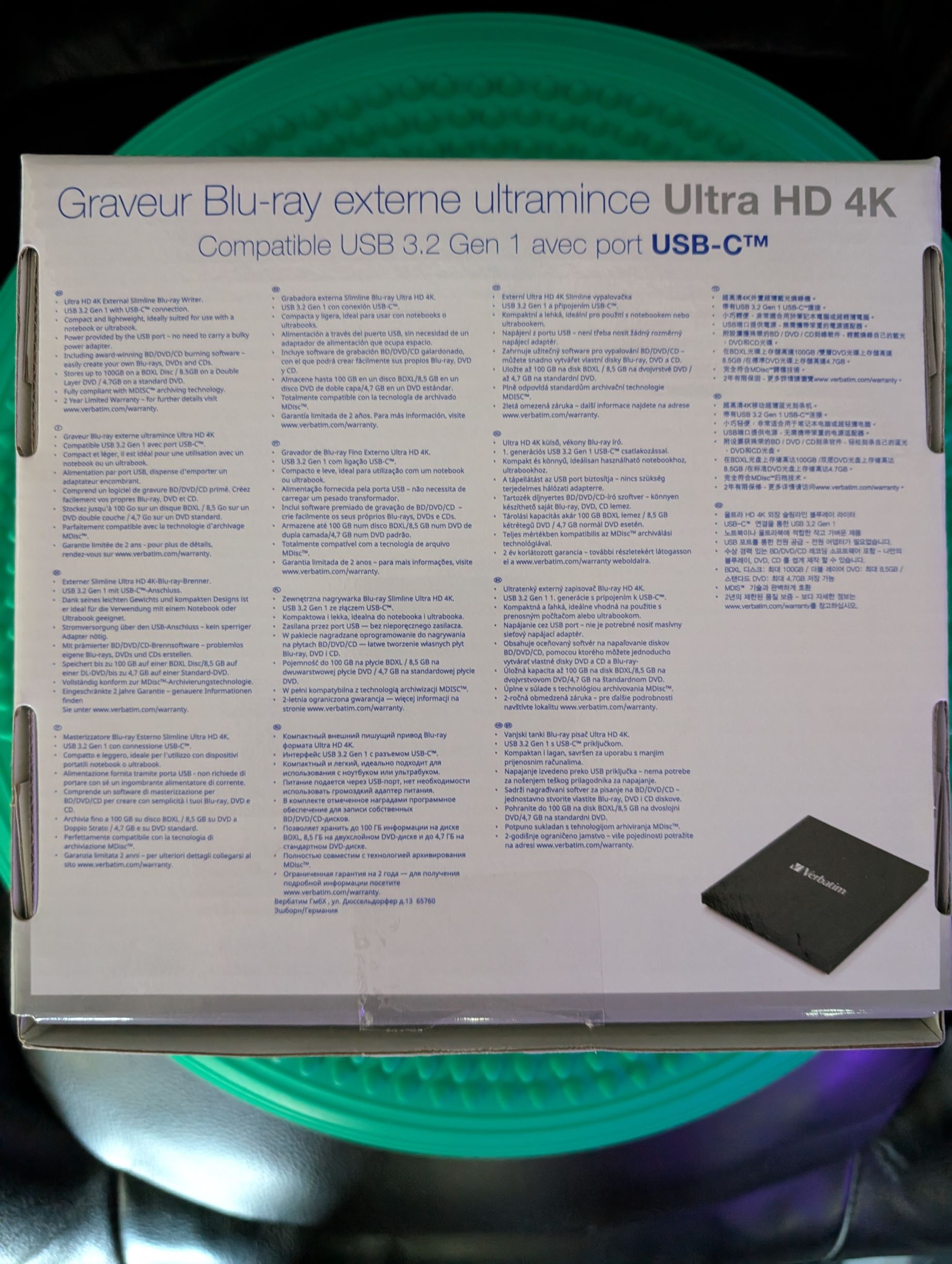

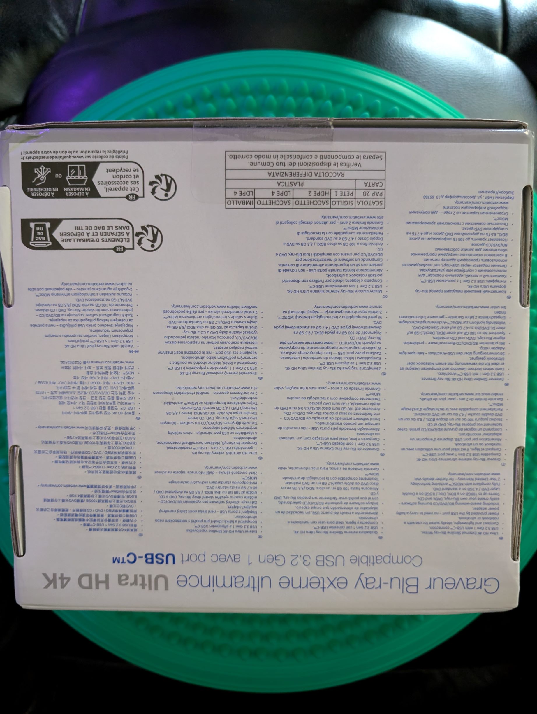

Re: Verbatim 43888 with LG drive?
Packaging

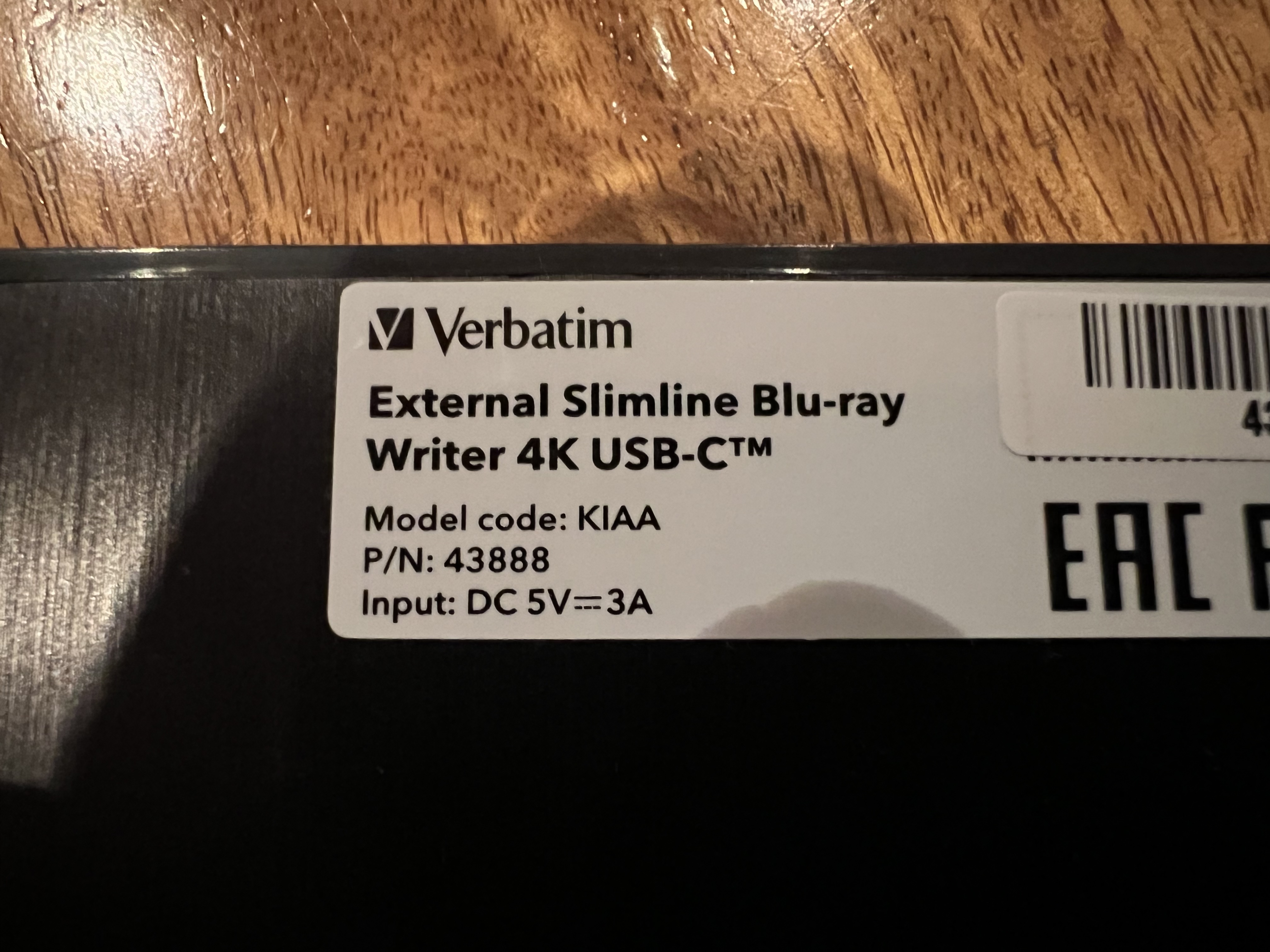

Thanks to ripthem we know based on the label on the physical drive that:
Model Code: KIAA = LG Drive
Model Code: KIAB = Pioneer Drive
I find that model code a little strange as you would think the Pioneer would be A as its an earlier version.

For what it is worth, I have a Pioneer Verbatim 43888 with the model code KIAA. I purchased the drive about 12 months ago.Seoska wrote: ↑Sun Dec 08, 2024 10:55 pmModel Code: KIAA = LG Drive
Would be good if someone can post a model code of an older version that at least 12 months old.
