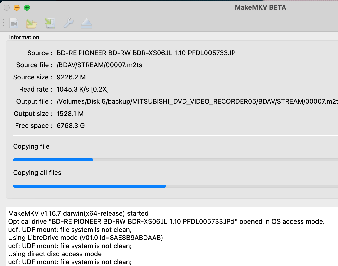

Excited to see Pioneer drives finally supporting LibreDrive!
I was expecting it to rip at full speed now, but I'm still seeing the slow ripping speeds seen in Pioneer drives.
Even with LibreDrive enabled, ripping speed is down to 0.2x at a whopping 1053K/s, though initally it would rip at around 2.0X speed.
This has been the same before LibreDrive was supported, so I'm not seeing any improvements.
スクリーンショット 2022-03-12 13.05.40.png (176.41 KiB) Viewed 13609 times
Why is this happening even with LibreDrive enabled?
Or do I need to change some settings to actually enable it?
Is the proprietary PureRead, quite spinning tech in these drives just don't play well with MakeMKV?
I was expecting dramatic improvements, but bummed that nothing has changed.
I also have an older USB2.0 based MATSUSHITA drive, though not LibreDrive compatible, would rip constantly at 2.0x making it much faster than the LibreDrive supported Pioneer drive.

Tried that with every possible combinations of PureRead ON/OFF, Spinning Speed Persistent Quiet/Quiet/Performance, including turning off both features but to no avail.

makemkv does complain the udf file system is not clean did you try another disc.
try an official bd not another disc made by a mitsubishi

Any retail BDs rip fast as it should.
DVD's are fast too, retail or recorded.
The problem is only with BD-RE discs recorded on a standard Blu-ray recorder.
Note that as written in the initial post, the same exact disc that rips slowly on the USB3.0 Pioneer drive, with or without LibreDrive, rips fast and flawlessly on an SATA or slower USB2.0 based drive that is NOT compatible with LibreDrive.
The disc is obviously not the cause of the problem but rather seems to be an issue with the combination of the Pioneer drive and MakeMKV, though I don't know if the particular drive itself is faulty or a compatibility issue in MakeMKV.

disable libredrive and see if its fixed
