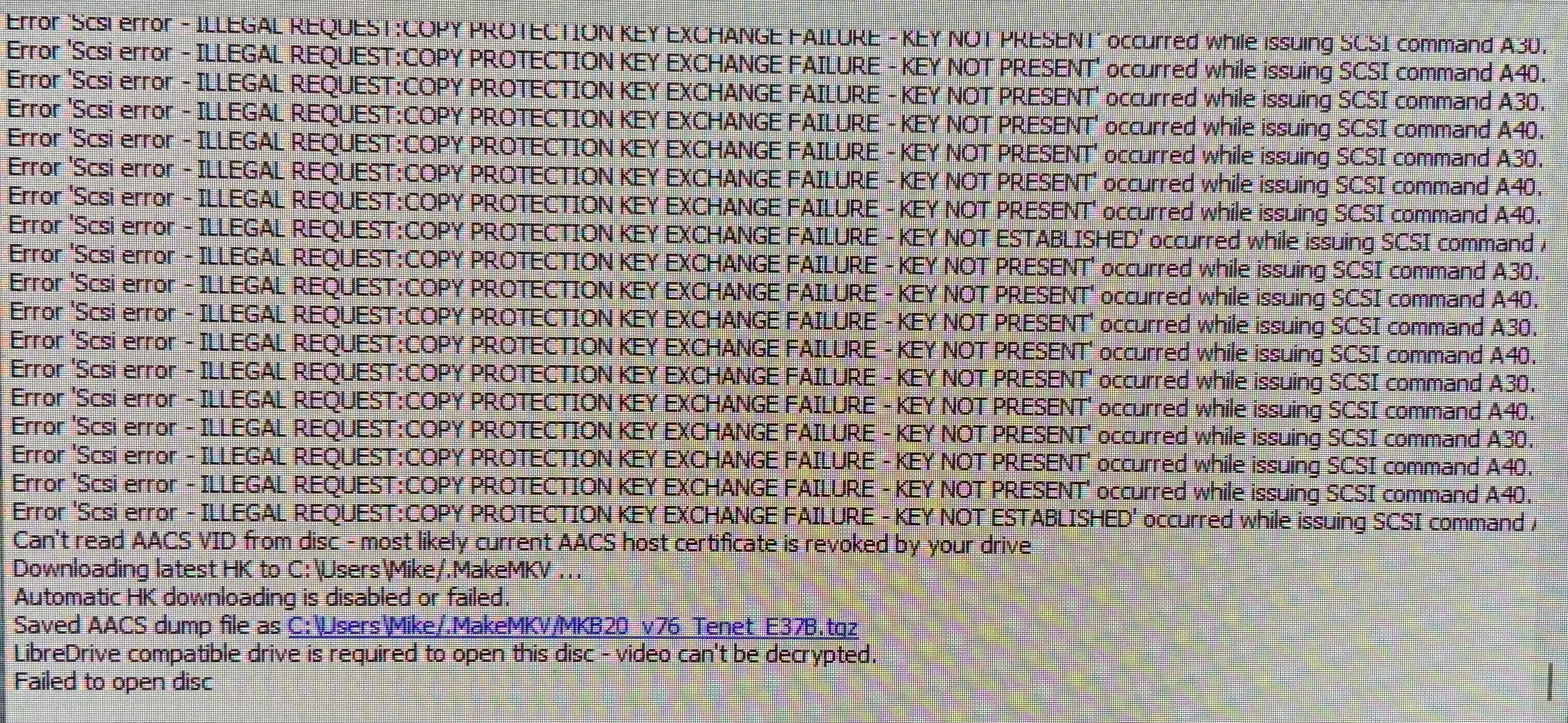

Here’s a screenshot of the errors
Re: LibreDrive Information?
Automatik HK downloading is disabled or failed.Re: LibreDrive Information?
Well, I've disabled every firewall, antivirus, etc on my PC, checked all the events on my UniFi UDM Pro to see if anything was being blocked, and made sure internet access is enabled in the preferences in MakeMKV, and I'm still receiving this error. Are you sure MakeMKV doesn't have access to the internet or is it because LibreDrive is not yet enabled?
It's probably your dns change it to google or cloud flare
8.8.8.8 or 1.1.1.1
Then you should be able to both flash the drive and download keys
8.8.8.8 or 1.1.1.1
That's exactly what my DNS is currently set at.
I also downloaded the sdflash tool and tried to flash the MK firmware, but that came back with an error too and quit.
- Posts: 5315
well then your isp is blocking it i could give you my sdf email me
