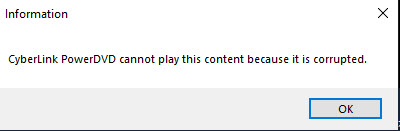

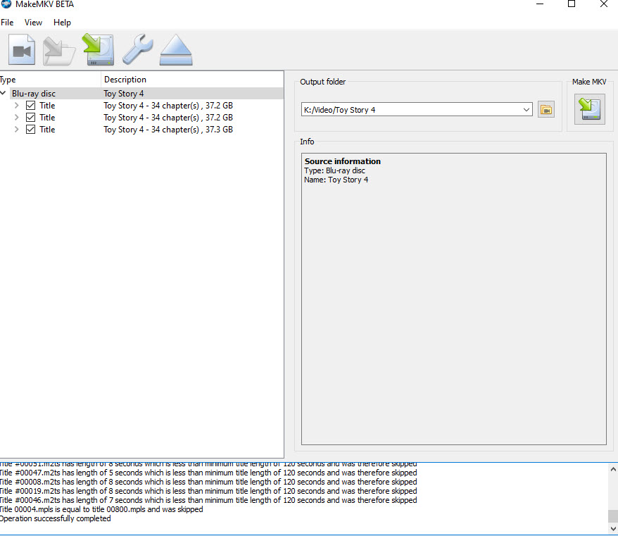

Thanks, Billy, appreciate it.. wow you are awesome replied back so quickly appreciate it.. and Thanks for the tip.. I ran it and seems it worked even though at the end I got an error message.. so my main question is even if the drive is now able to open and see UHD drives ... how can I make the movie play from the drive which software I have to use? clearly, Power DVD is not working .. it gives the error "cannot play this content as it is corrupted " BS
tried vlc and it gave an error too.. so all this firmware allows is to make Mkv file of the UHD drive to rip the disc and watch it?
PS C:\Program Files (x86)\MakeMKV> .\makemkvcon64.exe f --all-yes -d P: rawflash enc -i C:\Users\XXXX\Downloads\files\WH16NS60-1.02.bin ( was I supposed to use WH14NS40 1.02 file? )
Reading input file C:\Users\XXXX\Downloads\files\WH16NS60-1.02.bin
Current Drive ID: HL-DT-ST_BD-RE__WH14NS40_1.05_212005061444_XXXXXX
100% Operation finished
Program Flash NG 06/29/00
Command produced error code 0x8f062900
from mkv software it shows as downgraded

- Posts: 5820
Re: WH14NS40
your good to go leave the firmware as it is WH16NS60 fw is better.adnaanusa wrote: Tue Dec 08, 2020 7:16 am
OS device name: P:
Product: BD-RE WH16NS60
Revision: 1.02
Serial number:
Highest AACS version: 68
Firmware version: 1.02
Disc Information
Label: TOY_STORY_4
Timestamp: 2019-08-01 10:48:26
Data capacity: 55.82 Gb
Disc type: BD-ROM UHD
Number of layers: 2
Bus encryption flags: 80
you wont be able t watch with powerdvd you can only watch unofficially or rip the movies
to watch unofficially just check the vlc integration in makemkv and then in vlc select open disc bluray
Re: WH14NS40

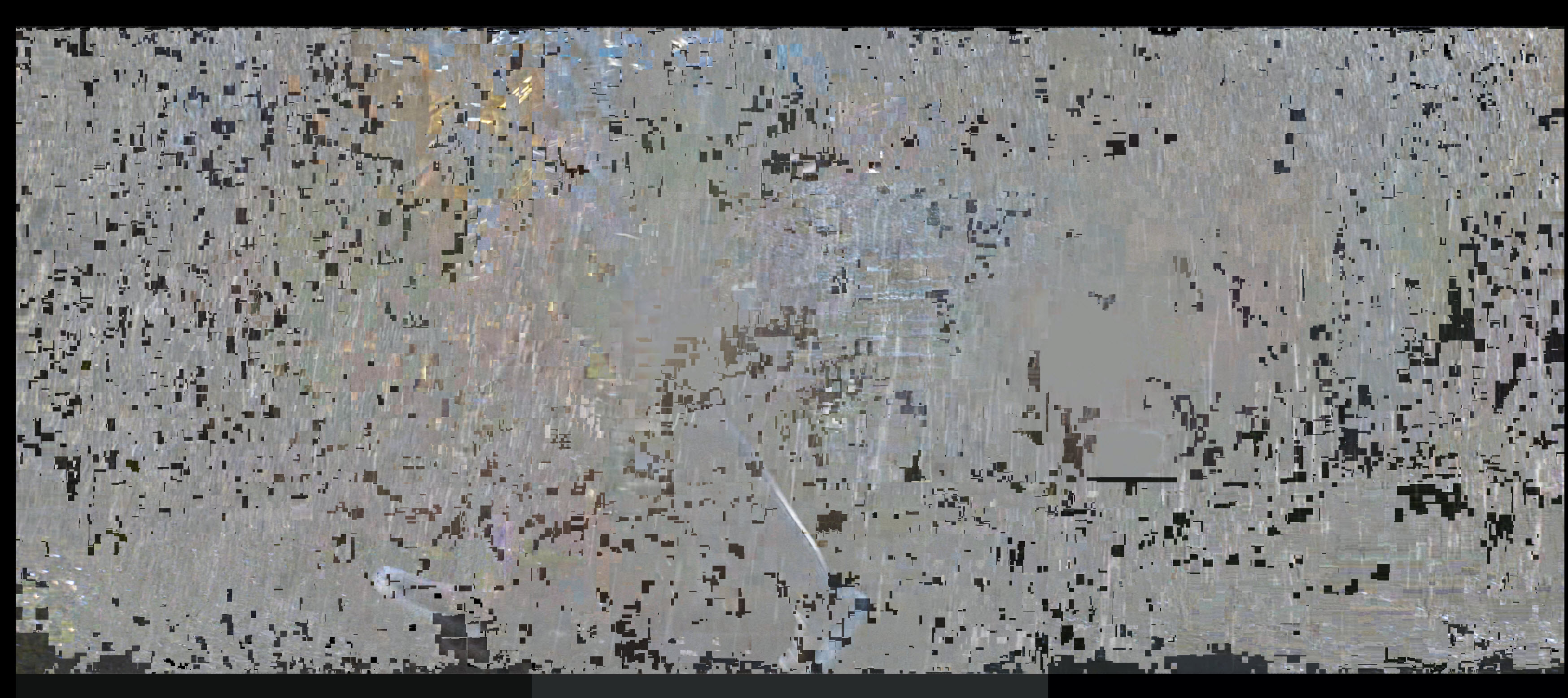

damn, this is not good. did the makemkv and vlc integration and got this output...is this because the drive speed is low? I get a pixellated video and it hangs in between .. I have always played my movies through pc and I like it and PowerDVD allows or does the sound output so well I didn't buy a standalone blu ray player etc .. with 4k i am not seeing any proper UHD pc drive if there is any please let me know which can be used along with power DVD.. but my guess it will cost a fortune? i saw somewhere to use UHD drive in pc even the pc needs to be updated to a certain intel generation processor or the motherboard... not sure if that is true.. i usually liked PowerDVD than vlc not sure why.. lol I liked how it outputs sound from the speakers... especially dialogue coming out of all speakers.. with standalone players it only comes from the center speaker.
Anyway, I am not liking this.. i got 4k UHD player but don't like how the sound is staged from my receiver to the speakers .. is there a way to move the drive back to its firmware I am thinking to just return this drive.. not sure yet will try few things with vlc and see if I can get a smooth picture with a proper lip/dialog sync ..

Re: WH14NS40
what is your cpu gpu and display?
i think its because your pc does not support h.265 decoding
it is true you need a specific cpu and motherboard for official UHD playback in powerdvdadnaanusa wrote: Tue Dec 08, 2020 8:24 am i saw somewhere to use UHD drive in pc even the pc needs to be updated to a certain intel generation processor or the motherboard... not sure if that is true..
Re: WH14NS40
1. As Billy advised your GPU needs to be capable of processing h.265. Also, yes, for full legitimate/legal UHD BD playback on PC straight from disc on official licensed players like PowerDVD without bypassing AACS protection(s) you need a fully SGX capable/compatible PC. The details as to what that means are are all listed in PowerDVD’s website and Google will provide thousands of detailed discussions on that as well. That horse has been beaten to death already a thousand times over, so no need to get into the details yet again here.adnaanusa wrote: Tue Dec 08, 2020 8:24 am damn, this is not good. did the makemkv and vlc integration and got this output...is this because the drive speed is low? I get a pixellated video and it hangs in between .. I have always played my movies through pc and I like it and PowerDVD allows or does the sound output so well I didn't buy a standalone blu ray player etc .. with 4k i am not seeing any proper UHD pc drive if there is any please let me know which can be used along with power DVD.. but my guess it will cost a fortune? i saw somewhere to use UHD drive in pc even the pc needs to be updated to a certain intel generation processor or the motherboard... not sure if that is true.. i usually liked PowerDVD than vlc not sure why.. lol I liked how it outputs sound from the speakers... especially dialogue coming out of all speakers.. with standalone players it only comes from the center speaker.
2. Look at software AnyDVD HD (again, Google is your friend) and see if that option is viable to you. They support on the fly decryption of some UHD content playback alongside PowerDVD. They have their own active support forum as well.
