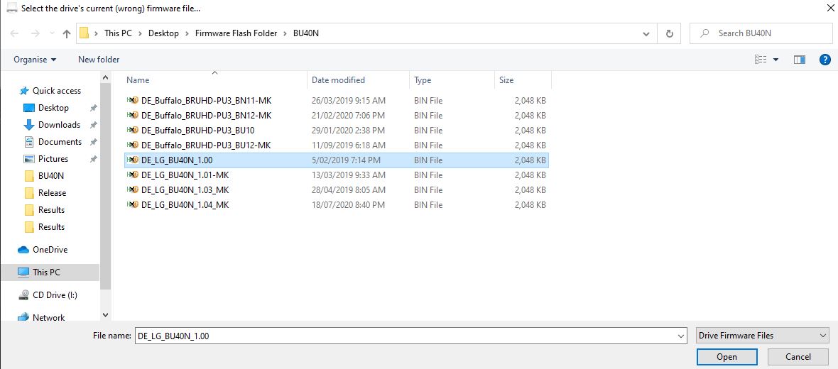

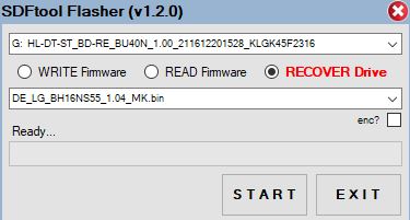

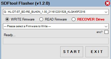

I've never had an old drive to test the recovery on. I've only had a desktop drive cross-flashed to slim drive firmware, so not exactly the same issue as yourself but the recovery method is supposed to be the same. See my example below...
Step 1: I have a BH16NS55 that has been accidently cross-flashed to slim drive BU40N firmware.
Step 2: I have selected the drive and clicked "Recover Drive" which opened up the filebrowser soI can select the current (wrong) firmware. I selected BU40N 1.00 as that is what is currently on the drive.
Step 3: I now select the firmware file to flash in the 2nd drop down box. As you can see, I selected BH16NS55 1.04 MK.
Step 4: Click START button to recover the drive. As you can see, my drive has been recovered and is now on BH16NS55 1.04 MK firmware.
