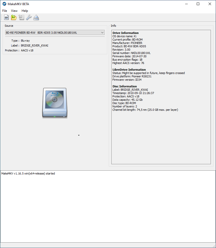

UHD aside, unless I misread Mike's initial post, I thought it would now support LibreDrive as one of the RS8xxx drives. My experience with an older BDR-XD05 on the RS8231 platform is similar:
Pioneer BDR-XD05.PNG (62.53 KiB) Viewed 86139 times
You should verify that you have internet access allowed since Makemkv needs to update sdf.bin to version 81. If you enable debug you can see which version is used when you rip a disc. If you have version 81 then it needs more work for Mike.
