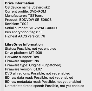

My problem is only, that my drive is not in the patch list, even if is has the status "possible, not yet enabled" in makemkv:
Can anybody help me here? ;)

Posts: 4543
Re: Attempting to flash in macOS
Your drive can not be made UHD compatible. Those must be based on the MT1959 chip.

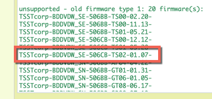

pmhCH
Posts: 17
Joined: Tue Dec 03, 2019 8:46 am
Post by pmhCH »
Yes, just saw MIke's post about those Samsung drives and mine seems not supported and probably never will be:
So one wonders why it still says "Possible, not yet enabled" in makemkv...

Posts: 4912
pmhCH wrote: Sat Oct 10, 2020 11:43 am Yes, just saw MIke's post about those Samsung drives and mine seems not supported and probably never will be:
It means that someday (now seems unlikely), your drive may support libredrive (but still, it will never be UHD capable!)

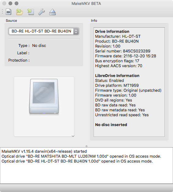

Got rid of the "enc" part of the command line. (My drive being quite new, I expected it to be firmware encrypted.)
Viola!
Screen Shot 2021-01-08 at 19.06.12.png (112.84 KiB) Viewed 54044 times
So, it *IS* possible to firmware flash on a Mac (OS X.13.6), without a virtual/boot camp Windows. For the record, my drive was an 'hp HLDS BDRE BU40N' with firmware BW42. It now considers itself an 'HL-DT-ST BD-RE BU40N' with firmware 1.00.
I am staying on FW 1.00 because I use DVDFab to do whole disc copies (.ISO). If anyone knows that DVDFab will work with a later firmware (1.03, 1.04), or a reason to use an MK firmware, please let me know.
