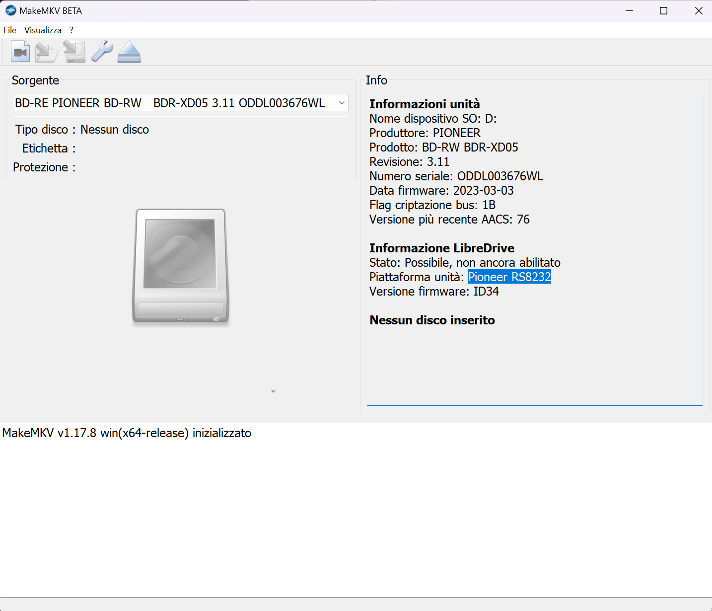

Dear Mike,
how can I fix my BDR-XD05TB?
Can't find the right information to do so.
The current status is "Possible, not yet enabled", and UHD discs can't be read by Makemkv and Windows too.
Thanks for helping,
Luca
Thanks for helping,
Luca
- Screenshot 2024-12-25 174603.png (95.39 KiB) Viewed 7913 times
Pioneer disabled ROM changes in their December 2022 update, making it (currently) impossible to update these drives to read UHD disks. Since the software that they authorize to use that mode isn't available anymore, those drives are useless as far as UHD is concerned.

Are you replying to me? If so should I try and return the drive?Woodstock wrote: ↑Wed Dec 25, 2024 5:11 pmPioneer disabled ROM changes in their December 2022 update, making it (currently) impossible to update these drives to read UHD disks. Since the software that they authorize to use that mode isn't available anymore, those drives are useless as far as UHD is concerned.
Yes, your drive was built after they disabled UHD. If your purpose is to rip UHDs, then yes, you should return that drive for a refund.
