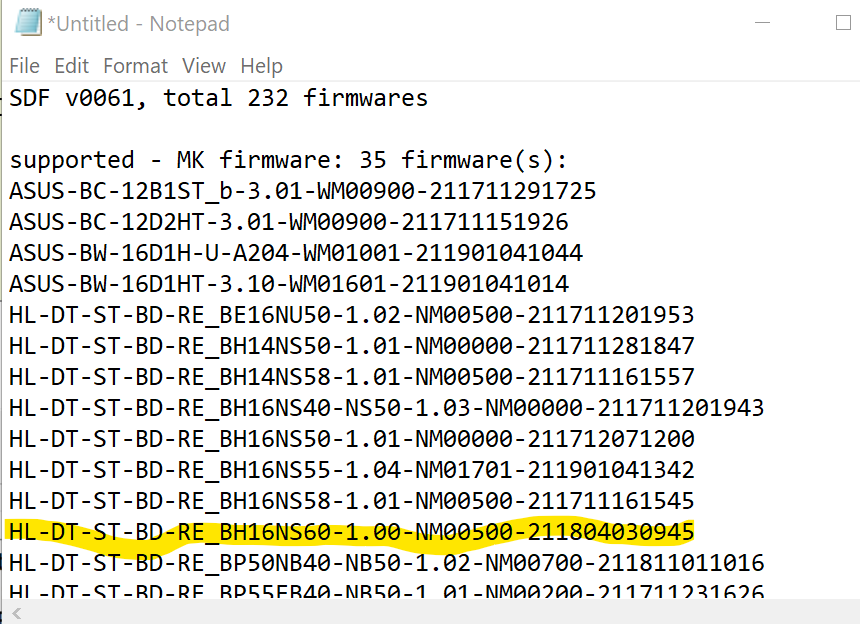

I just installed my new UHD Bluray drive: a Hitachi/LG BH16NS60 with firmware version 1.00 and date as listed in the supported LibreDrive firmware list on the thread here at this forum.
supported frimwares.png (68.11 KiB) Viewed 16193 times

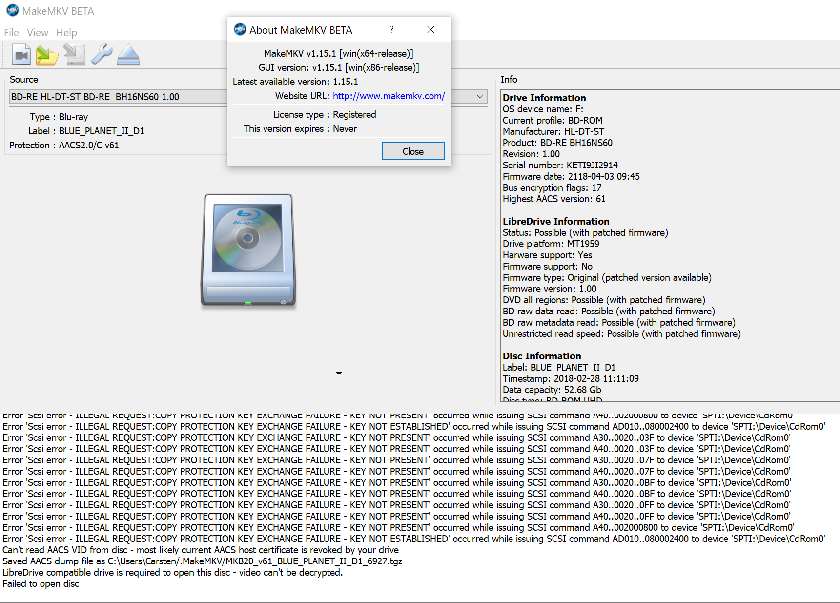

However MakeMKV fails to rip the UHD disc with these messages and info (in attached screenshot).
What is wrong?
As I read from the blog post about LibreDrive, makeMKV should be able to rip from this drive with no problems...?

Have you or anyone else previously flashed this drive’s firmware at all?
Posts: 2781
Re: Hitachi drive BH16NS60 on LibreDrive positive list fails
Post by SamuriHL »
No, this seems new. It won't be necessary to flash it but Mike is going to have LibreDrive support for that firmware.
