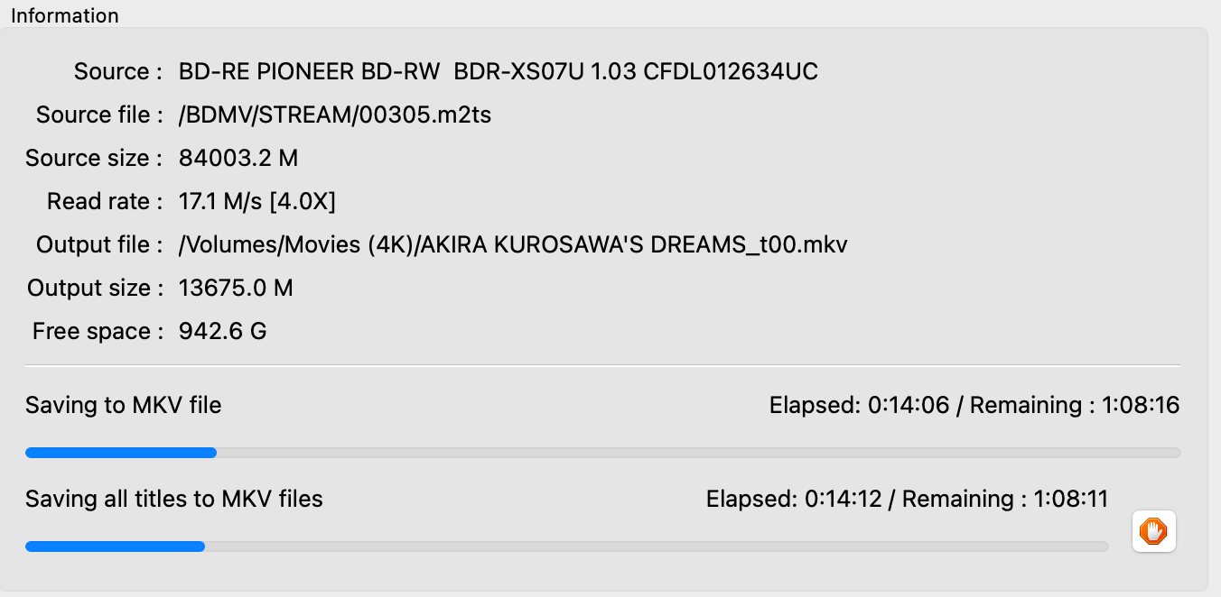

Hello all. Forgive if this has been answered but I havent seen it.
I bought a Pioneer Drive a couple years ago to start my home server from my UHD collection, only to find out my drive had a 2023 firmware, so no go. (XS07U)
While in Japan, took a chance on different S07 model and was fortunate to have a 2022 firmware, and arranged to have the drive enabled with a fellow member on this site.
Been checking in periodically to see if the issue has been resolved so that I could also enable my original drive, but it's been "coming soon" every time I checked.
However, the other day, I accidentally put a UHD disc in the unpatched drive, and it ripped! Did a few more to confirm, and the drive info now says:
OS device name: /dev/rdisk5
Manufacturer: PIONEER
Product: BD-RW BDR-XS07U
Revision: 1.03
Serial number: CFDL012634UC
Firmware date: 2023-01-06
Bus encryption flags: 13
Highest AACS version: 82
Drive platform: RS8E21
Firmware version: 1.03/ID05
Disc Information
Label: AKIRA_KUROSAWAS_DREAMS
Timestamp: 2023-06-02 09:47:32
Protection: AACS2.0/C v77
Data capacity: 93.22 Gb
Disc type: BD-ROM UHD
Number of layers: 3
Bus encryption flags: 80
So has this been solved? I didn't apply any firmware mods or anything, so I'm a little perplexed.I did have one disc give me an error, but 7 successful so far.
Thanks again to everyone for their continued efforts to make this hobby work!
Screenshot 2026-05-06 at 8.36.05 PM.png (106.25 KiB) Viewed 415 times
