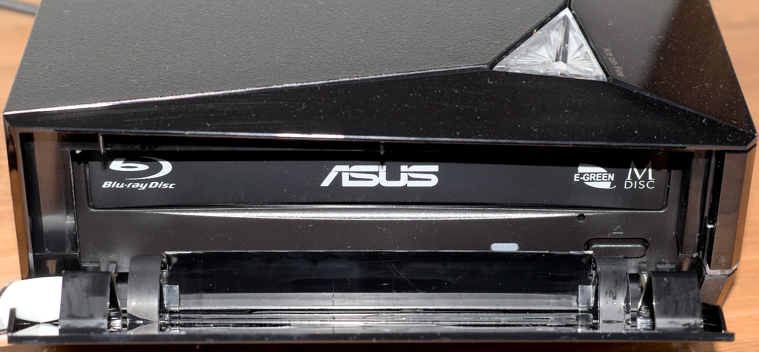

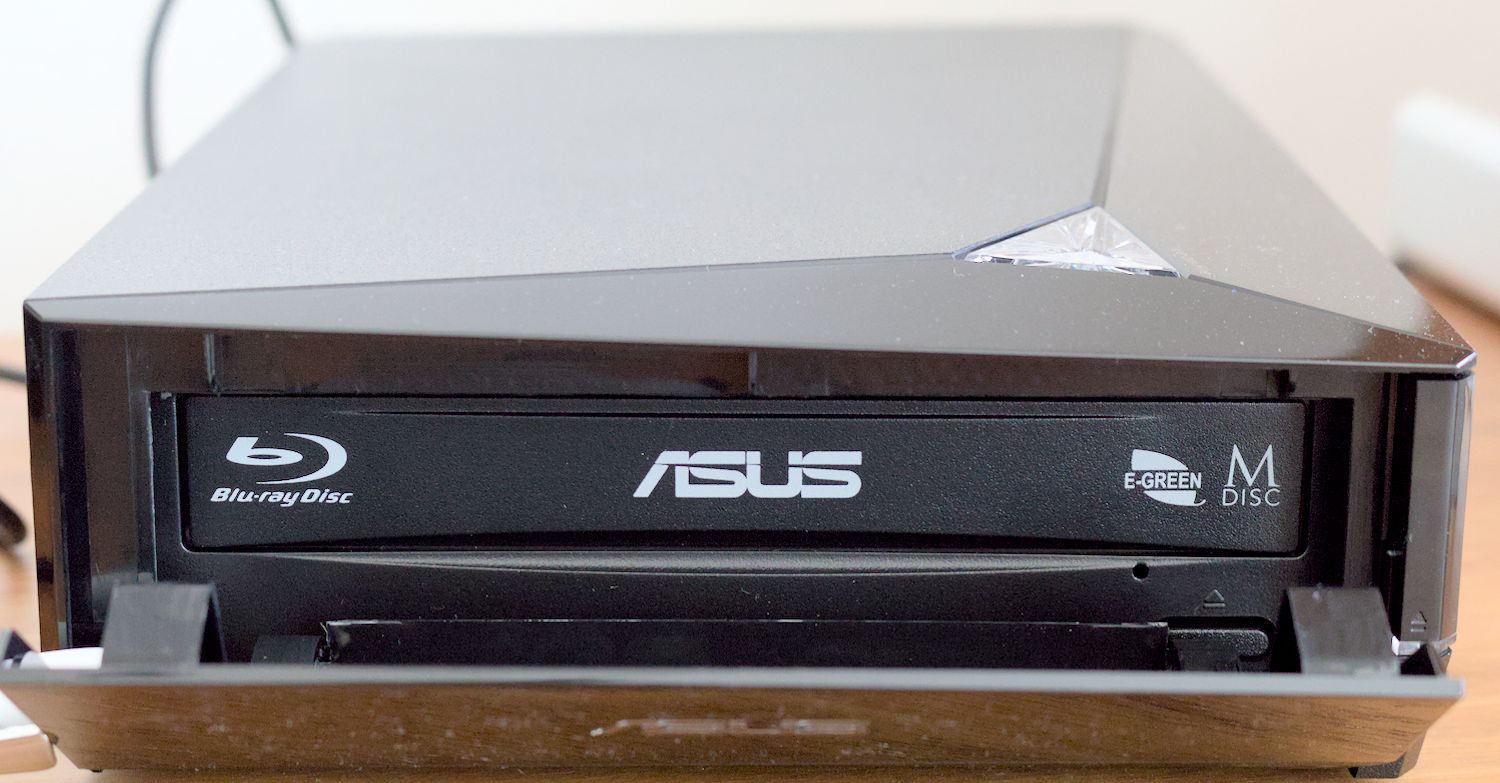

This is a observation. I noticed while looking at both ASUS BW‑16D1X‑U boxes one with LG BH50N / LG BH16NS40 the box color is white with slight purple tint - only has the windows 11 logo on the front. While the one with Pioneer 212t the box color is white - Mac OS and Windows 11 logo on front and side where the serial number is has a sticker made it Taiwan. Both have the same built year.

The first of the two I bought contains a BW-16D1HT, S/N starts with TCD an was built in December 2025.

Can this really be a drive from LG? The front looks exactly like an Asus BW-16D1HT. Does Asus sometimes slap the faceplate of an Asus BW-16D1HT onto drives from other manufacturers and sell them as Asus drives?

As mentioned, ASUS do not make drives. They are OEM, mostly from LG and Pioneer. The BW-16D1HT is a rebadged LG WH16NS40.Ralf Scheibler wrote: ↑Sat Apr 11, 2026 1:23 pmCan this really be a drive from LG? The front looks exactly like an Asus BW-16D1HT. Does Asus sometimes slap the faceplate of an Asus BW-16D1HT onto drives from other manufacturers and sell them as Asus drives?
