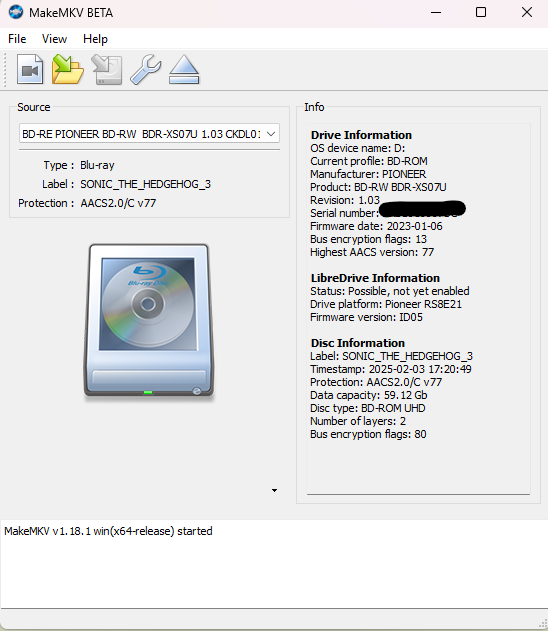

Hello, here is my drive.
- Screenshot 2025-05-28 221926.png (68.94 KiB) Viewed 476 times
