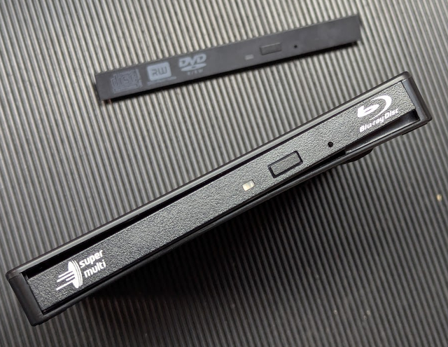

Yeah, you noticed that. That second enclosure was pretty ugly when it arrived but my hopes were not high to start off with. Let's get the good stuff out of the way first though.
This drive enclosure - https://www.amazon.co.uk/dp/B0CKQYVW5N - DOES pass the drive's parameters so it can be used to flash firmware and be used for a LibreDrive.
There, that didn't take long.
It's designed for 12.7mm drives but sold as being for 9.5mm drives. Let's give the supplier the benefit of the doubt and assume that they have been misinformed and that they are not deliberately trying to deceive. If you should try to fit a 9.5mm drive in it doesn't go in level (the recess for the captive cable fouls on the drive) so although you can get a 9.5mm drive in there, it is at the expense of it being twisted (wonky at best) and putting undue strain on the internal SATA connections. Dust and small pets will find their way in there.
Furthermore it might have USB C and USB 3 connectors on it, but at the other end of the cable is a micro USB connector on the PCB and an INIC-1618L SATA bridge on it (which seems to be the deciding factor in being able to read the drive's parameters so far) which means it is in fact USB 2.

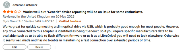

So it's not only cheap, it's pretty nasty as well. I was in two minds about keeping it though and binning the enclosure part and using the electronics as a USB to SATA cable because the "Slim SATA" cables that are everywhere do not work properly in that they always pass a "Generic" ID and not that of the drive. I've taken 3 for the team and they all have the INIC-3639 bridge which is USB 3.2 compatible (yay !) but cannot be used to flash the drive's firmware or be used as a LibreDrive (boo !) because of the "Generic" ID issue.
As you can probably tell the enclosure has gone back and a suitable review left. I have also started leaving some reviews for the "Slim SATA" adapters in case this helps anyone else going forward.
