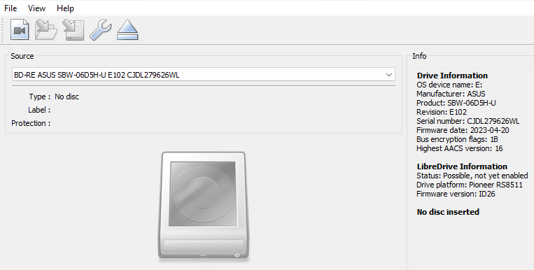

Hello Everyone,
I'm still quite new to this, so even after a few hours browsing the Forum, please forgive me if I ask any questions that seem obvious.
I was wondering if I could get LibreDrive for the unit I am using and was looking if someone could provide me some guidance to help me get there.
Here are my Drive info:
OS device name: E:
Manufacturer: ASUS
Product: SBW-06D5H-U
Revision: E102
Serial number: [redacted]
Firmware date: 2023-04-20
Highest AACS version: 16
Firmware version: ID26
Also I was wondering, if in case of standard DVDs and BDs, LibreDrive compatibility would make any difference in quality?
I have a minority of 4K Blue-rays, got mostly BDs standard and old DVDs.
Thank you very much for your help.
Stefano
ASUS SBW-06D5H-U
ASUS SBW-06D5H-U

Re: ASUS SBW-06D5H-U
Unfortunately, any firmware date on or after 12/22/2022 on Pioneer drives are blocked by the manufacturer from being upgraded to ripping UHD.Firmware date: 2023-04-20
But could still be used to rip Blu-Rays and DVDs?
Yes, it should work well on non-4K disks.
