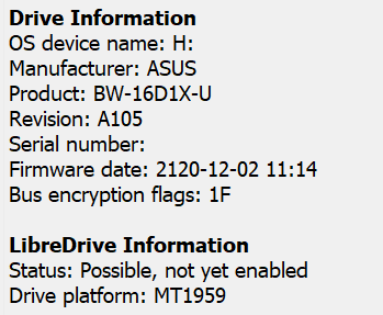

enenine
Joined: Sun Jan 19, 2025 7:13 pm
Re: Asus BW-16D1X-U
Post by enenine »
Can someone send me instructions as well? I'm happy to self-service more if I need to be redirected, though the trend seems to be to ask for a PM? Thanks for any pointers!
OS device name: /dev/sr0
Manufacturer: ASUS
Product: BW-16D1X-U
Revision: A105
Serial number: ...
Firmware date: 2120-12-02 11:14
Bus encryption flags: 1F
Highest AACS version: 40
Posts: 4176
Re: Asus BW-16D1X-U
enenine wrote:
Sun Jan 19, 2025 7:24 pm
Manufacturer: ASUS
Product: BW-16D1X-U
Revision: A105
Serial number: ...
You have a LG drive. Read here:
viewtopic.php?f=16&t=19634

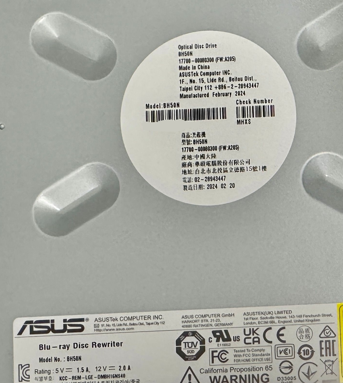

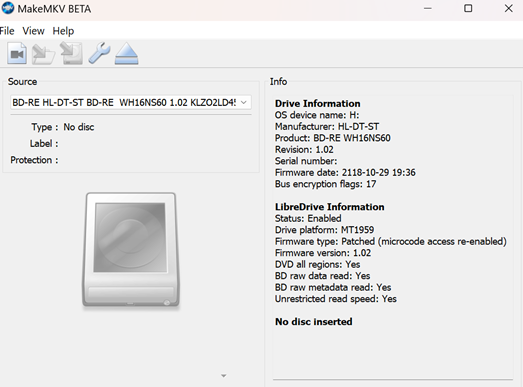

hi just wanted to share my results with this same drive Asus BW-16D1X-U
Screenshot 2025-01-29 140451.png (14.42 KiB) Viewed 13906 times
images is of the drive and what makemkv reported
odd the label says a205 and makemkv detected a105
but the bh50N was gold to me
SDFtool Flasher (v1.3.5)
used fw: HL-DT-ST-BD-RE_WH16NS60-1.02-NM00100-211810291936
Screenshot 2025-01-29 173340.png (86.71 KiB) Viewed 13906 times
flashed w/o errors
