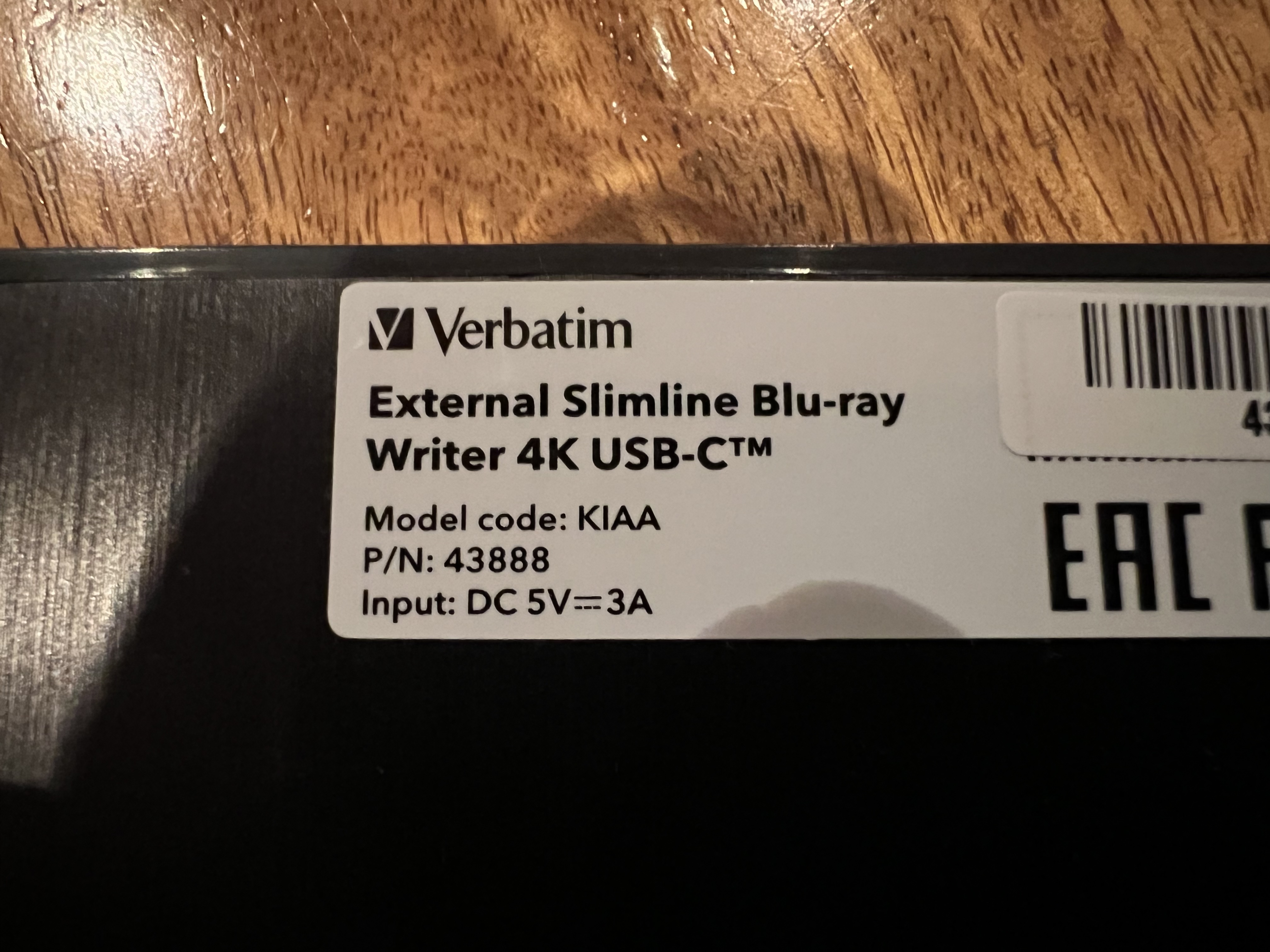

Re: Verbatim 43888 with LG drive?
Would have preferred the Pioneer version but have flashed the LG drive to firmware 1.03MK and its ripping with no issues.
Went into a bricks and mortar store to compare the packaging and they are identical. There is no unique identifier on the box to know whether or not the drive is a LG or Pioneer. So from here on in it will just be pot luck on which drive you receive. Unless you know the store has really old stock.
Thanks to ripthem we know based on the label on the physical drive that:
Model Code: KIAA = LG Drive
Model Code: KIAB = Pioneer Drive
I find that model code a little strange as you would think the Pioneer would be A as its an earlier version.
Would be good if someone can post a model code of an older version that at least 12 months old.
For what it is worth, I have a Pioneer Verbatim 43888 with the model code KIAA. I purchased the drive about 12 months ago.Seoska wrote: Sun Dec 08, 2024 10:55 pm Model Code: KIAA = LG Drive
I have both the Pioneer version and the LG version. From what I can tell, the bottom of the box is a little different and the LG drive tray fascia plate has the Super Multi and Blu-Ray logo's on them whereas the Pioneer version drive tray fascia plate is all black.
The Verbatim 43888 containing the LG BU40N has a picture of the drive in the bottom right corner. Looking at the box may help you if you are purchasing from a physical store...

if its the BU40N see below for guide or if you want an auto flasher me and marty have that toomakwm wrote: Sun Dec 15, 2024 7:45 am Hi Seoska-
I got the same Verbatim LG Drive from Amazon as yours (and it is not supported by MakeMKV) too. I bought the Verbatim 43888 UHD Drive from Amazon AU (Model Code: KIAA, P/N: 43888), but the order was fulfilled by Amazon Germany.
I am unfamiliar with firmware flashing. May I know how do you flash its firmware?
What software tools you use?
And from where I can download the correct firmware version to be used to flash the drive’s firmware?
Appreciate your help and advice. Thanks in advance!
