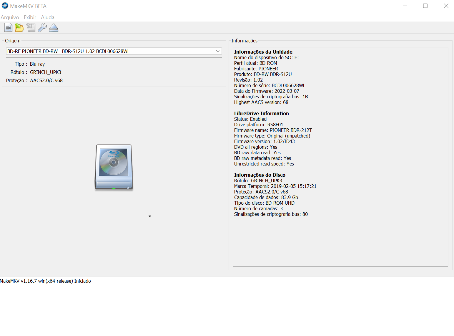

Pioneer BDR-S12UHT
Pioneer BDR-S12UHT Firmware 1.02
- Posts: 10998
Re: Pioneer BDR-S12UHT
And?
Lbento
- Posts: 10
- Joined: Thu May 26, 2022 9:57 pm
Can update to 1.02, Not UHD frendely but can rip blurays
- Posts: 6352
You should be able to rip UHD with that
Lbento
- Posts: 10
Yes. With makenkv i can.
