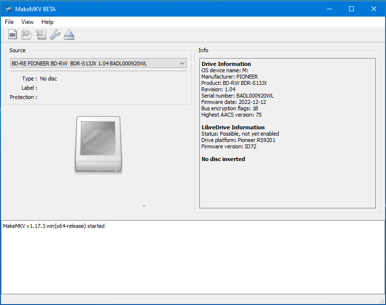

Not working anymore with Pioneer BDR-S13JX after upgrading firmware from 1.03 to 1.04.
MakeMKV v1.17.3
Posts: 4475
See my reply to your other post.
