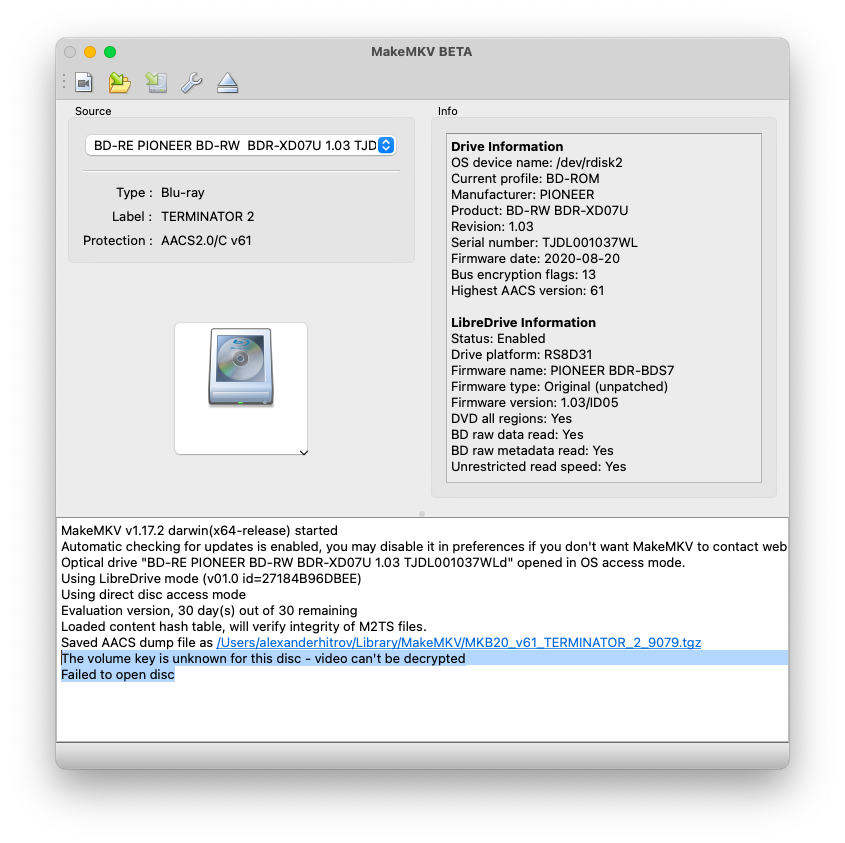

I'm having an issue ripping a UHD disk with my newly acquired drive.
The message I get is:
Manufacturer: PIONEER
Product: BD-RW BDR-XD07U
Revision: 1.03
Serial number: ADD**********
Firmware date: 2020-08-20
Bus encryption flags: 13
Highest AACS version: 76
Drive platform: RS8D31
Firmware version: 1.03/ID05
Let me know what else I can post to assist with this issue. Thanks in advance!

What's the title of that UHD? Do you have internet enabled in Makemkv?tryax wrote: ↑Mon Jan 30, 2023 10:58 pmHi,
Revision: 1.03

I'm trying to backup the new Dune movie UHD BluRay.Coopervid wrote: ↑Tue Jan 31, 2023 9:44 amWhat's the title of that UHD? Do you have internet enabled in Makemkv?tryax wrote: ↑Mon Jan 30, 2023 10:58 pmHi,
Revision: 1.03
I have internet enabled in MakeMKV, but every other time I launch it, I get "Automatic SDF downloading is disabled or failed."
Nevermind Coopervid, It was my dumb router blocking IPs based on Geolocation causing the SDF and HK downloads to fail repeatedly. I found the answer on Reddit that pointed me in the right direction. Thanks!tryax wrote: ↑Tue Jan 31, 2023 2:11 pmI'm trying to backup the new Dune movie UHD BluRay.Coopervid wrote: ↑Tue Jan 31, 2023 9:44 amWhat's the title of that UHD? Do you have internet enabled in Makemkv?tryax wrote: ↑Mon Jan 30, 2023 10:58 pmHi,
