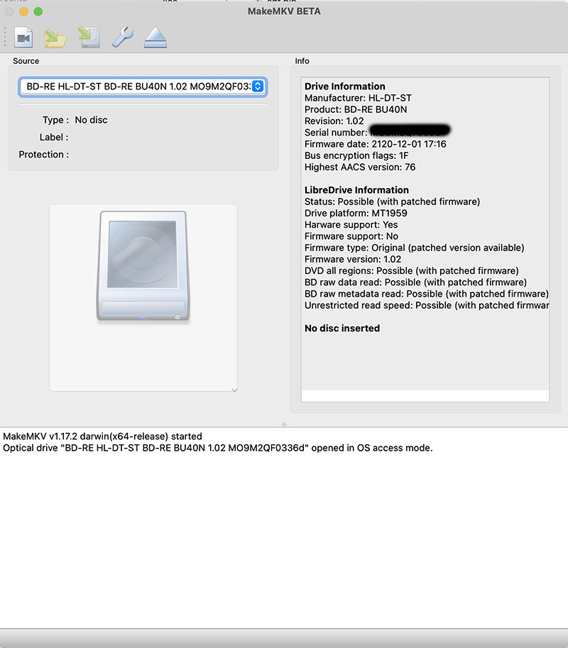

I appear to have a similar (not flashing) problem.
MacOS Ventura and a brand new out of the box Archgon MD-8107S-U3YC-UHD drive. The drive has 1.02 firmware.
I downloaded the full pack and followed the instructions [viewtopic.php?t=19634].
I ran the Terminal command and got:
Reading input file /users/grahambb/dvdflash/HL-DT-ST-BD-RE_BU40N-1.03-NM00000-211810241934.bin
Current Drive ID: HL-DT-ST_BD-RE_BU40N_1.02_212012011716_MO9M2QF0336
yes
100% Operation finished
Done successfully
However, the drive still seems to be at 1.2
I am a complete and utter novice at this, so any help would be appreciated.

In your command use enc as your drive had encrypted firmware.

Still see 1.02 after this:
Retina MacOS % ./makemkvcon f -d '/IOBDServices/FC2CB729' -f /users/grahambb/dvdflash/sdf.bin rawflash main enc -i /users/grahambb/dvdflash/HL-DT-ST-BD-RE_BU40N-1.03-NM00000-211810241934.bin
yes
Done successfully

No main just enc please read guide
golfbravo
Joined: Fri Nov 04, 2022 7:22 pm
Re: Archgon slim BU40N not flashing?
Post by golfbravo »
Thanks for that. Now at 1.03
That has reveled other issues, but I'll search for those separately.
