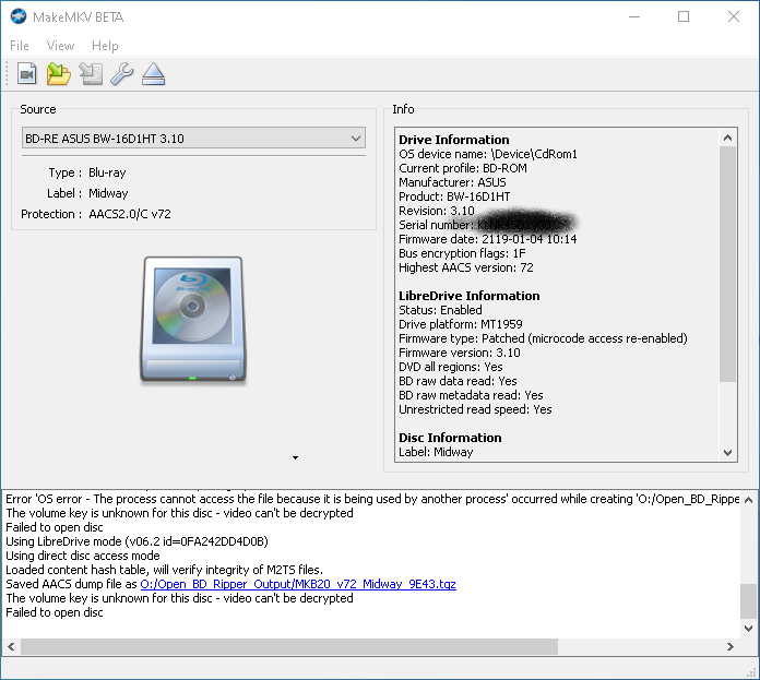

Hi there sorry if this double post..
i have the same drive and the flash seem to work as in attached pic but iam unable to rip apollo 13 or midway
any help would be great
thanks
thanks

Because makemkv can't write to the data directoryeastwood1965 wrote: ↑Thu Aug 19, 2021 2:22 amHi there sorry if this double post..
thanks

Re: Asus BW-16D1X-U
so goes that mean the drive will not work???

Re: Asus BW-16D1X-U
so does that mean the drive is not compatible ??
- Posts: 5549
Re: Asus BW-16D1X-U
No it means you need to fix your path to a place your os and makemkv can write.

Re: Asus BW-16D1X-U
Iam sorry billy. But iam very new at this. So my OS meaning operating system. So does this mean a director has to be made on the C: drive in prefences general on makemkv??!! Again sorry for being a noob.
- Posts: 5549
Re: Asus BW-16D1X-U
You changed the data directory of makemkv to o:open bd rippereastwood1965 wrote: ↑Thu Aug 19, 2021 4:00 amIam sorry billy. But iam very new at this. So my OS meaning operating system. So does this mean a director has to be made on the C: drive in prefences general on makemkv??!! Again sorry for being a noob.
Change it to back to default

Re: Asus BW-16D1X-U
Thanks a lot billy. That did it. Thanks again !!!
