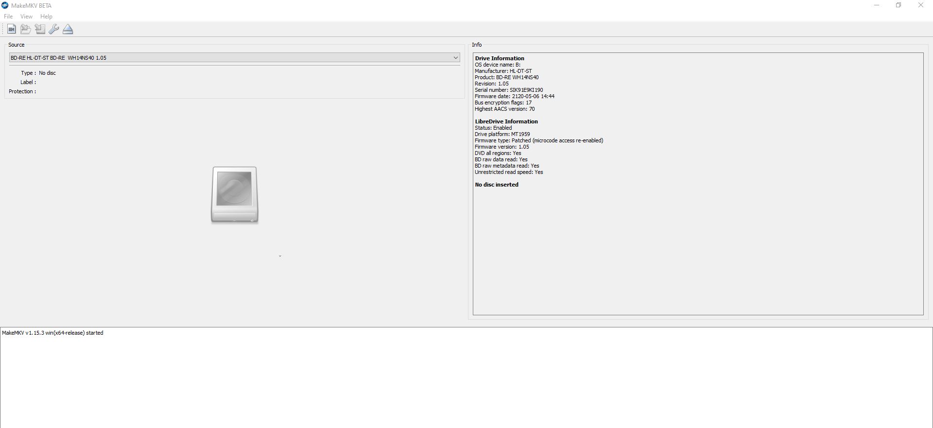

Hello, I updated my LG Drive WH14NS40 to firmware patch 1.05 today, but now it won't recognize any discs. Would anyone be able to assist me in getting this back up an running? I used firmware HL-DT-ST-BD-RE_WH14NS40-NS50-1.05-NM00900-212005061444.

- WH14NS40 image.JPG (84.45 KiB) Viewed 13965 times

Looks fine. Did you reboot your PC?

Yes, I rebooted the drive. The only issue is that it keeps showing "No disc" even though I have a DVD or Blu-Ray in the drive.

Well there is your problem I guess you dident read the uhd guide that says 2015+ and mt1959.Brianebrown1979 wrote: Fri Dec 18, 2020 9:18 pm I bought it a while ago, probably close to the release date (so 8 years ago).
You should be able to recover it with sdf tool just select recovery and old ns40 fw
