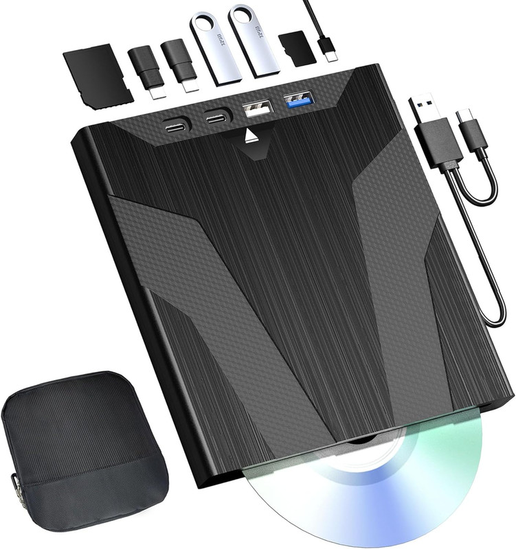

Was doing a little research and I think this is a rebranded Hitachi-LG BP55EB40 (often referred to as BP55) drive?
Google says I can enable 4K with the firmware BU40N 1.00 or specific 1.03-MK version? Anyone know if this is true?
MakeMKV info:
OS device name: E:
Product: DVDRW/BDROM CA10
Revision: A110
Serial number: XXXXXXXXXXX
Highest AACS version: 82
Thanks for any info. This drive is kind of cool!

Can't tell from that. Post the Libredrive info section too. Although I seriously doubt it. From what info I can find, the CA10 is from around 2009-2012 thus too early to be flashed for UHD. I also doubt that it's a BP55. What makes you think that?

MartyMcNuts wrote: Can't tell from that. Post the Libredrive info section too. Although I seriously doubt it. From what info I can find, the CA10 is from around 2009-2012 thus too early to be flashed for UHD.
Here it is:
Firmware version: 3.10
That came up in a google search result.

A link might have been helpful?!?
In the drive info section the firmware date is missing. What is this date?
If the date is late 2015 or newer and the drive platform does show as MT1959, so yeah, you might be able to flash it, if it's cheap enough and you feel the reward is worth the risk.

Sorry about that. I might have selected the wrong drive on my computer. Let's start over.
Drive link:
https://www.amazon.com/juwuoi-External- ... B0DQKFLBYS
This is the only info MakeMKV gives me. No firmware date.
OS device name: E:
Revision: A110

Yeah, you must have provided the wrong libredrive info section previously as that says firmware 3.10, which is probably an ASUS BW-16D1HT.
No Libredrive info section for this CA10 drive?? As I mentioned, I'm pretty sure this is from 2009-2012 thus too old and wrong drive platform for UHD compatibility.
No, I meant a link to the google results showing why you think it might be a BP55.
