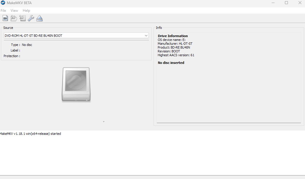

I recently bought a bargain Verbatim 43888, with LG BU40N drive, unfortunately it is bricked, how can I fix it ?
Zrzut ekranu 2025-06-03 165406.png (31.04 KiB) Viewed 4820 times
Zrzut ekranu 2025-06-03 165943.png (19.53 KiB) Viewed 4820 times

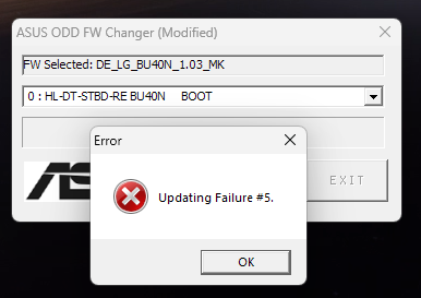

What did you do to it??
You could try using the old ASUS flasher and flash BU40N 1.03-MK firmware. It doesn't do any checks whatsoever so should be able to flash the firmware. viewtopic.php?p=70766#p70766

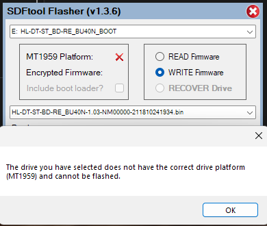

im also curious what you did
but encrypted fw makes recovery much more complicated it seems
modified lg flasher can also unbrick https://drive.google.com/file/d/102V7DU ... drive_link

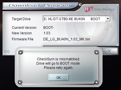

I bought the used bricked drive. I tried to upload through Flasher asus, and LG, unfortunately I got errors popping up.
What else can I do with it ? Thanks for your help.
