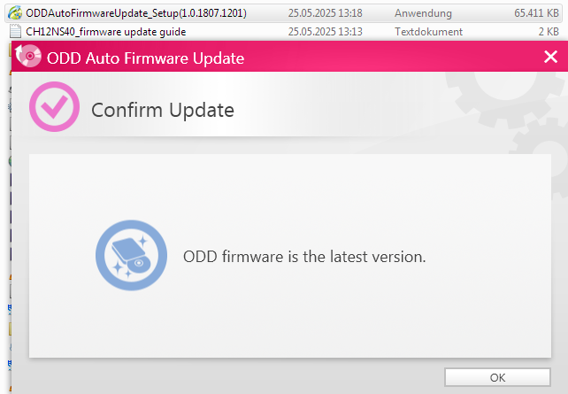

edit> attempting to flash original firmware not succesful, since ODD app says it has alreaadyu latest firmware applied.
maybe someone can share the original firmware, file to flash for windows thanks,

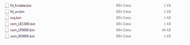

hello , thanks , i have found the backup file , but SPI flash cannot read it since it is TAR file and SPI flash attempting to read/write bin file.
when i extract tar file, getting several file, maybe you can help restore the proper firmware.

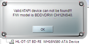

have now found the original firmware .exe from LG for the drive,
but it would not allow me to use it since the drive is not recognized as CH12NS40 but now as WH16NS60

The dump you made was of an encrypted firmware, so the actual original firmware is not in the dump . tar. What's in that dump are drive settings. Your original firmware is lost.
I agree with others that suggest your blue laser failed.
