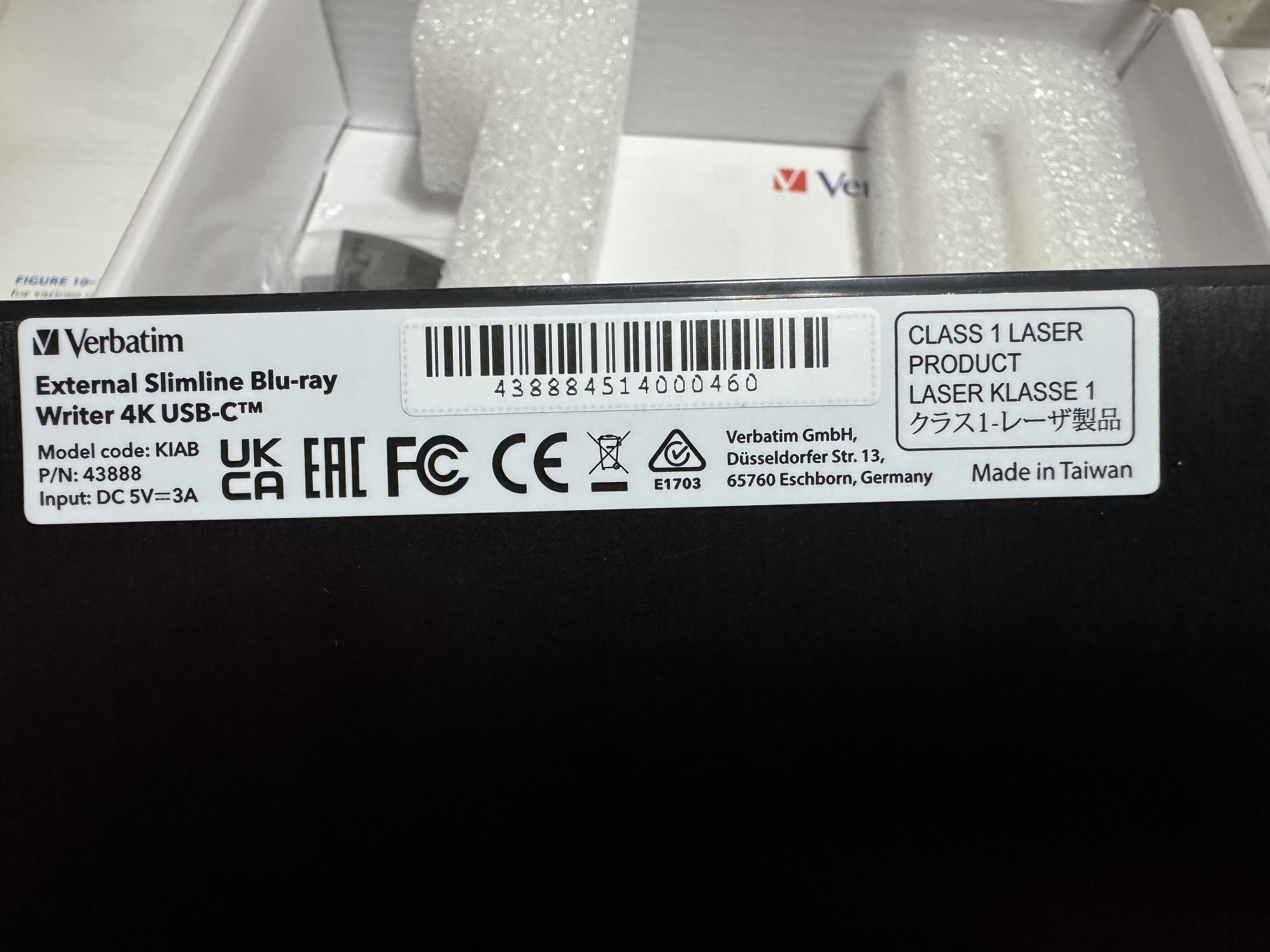

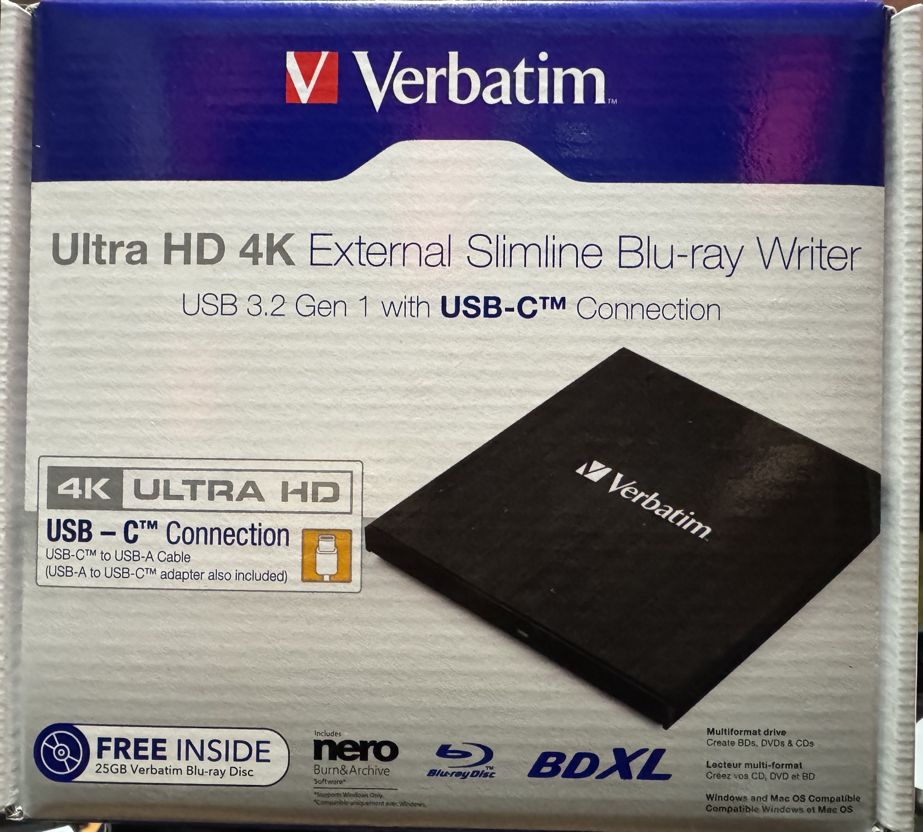

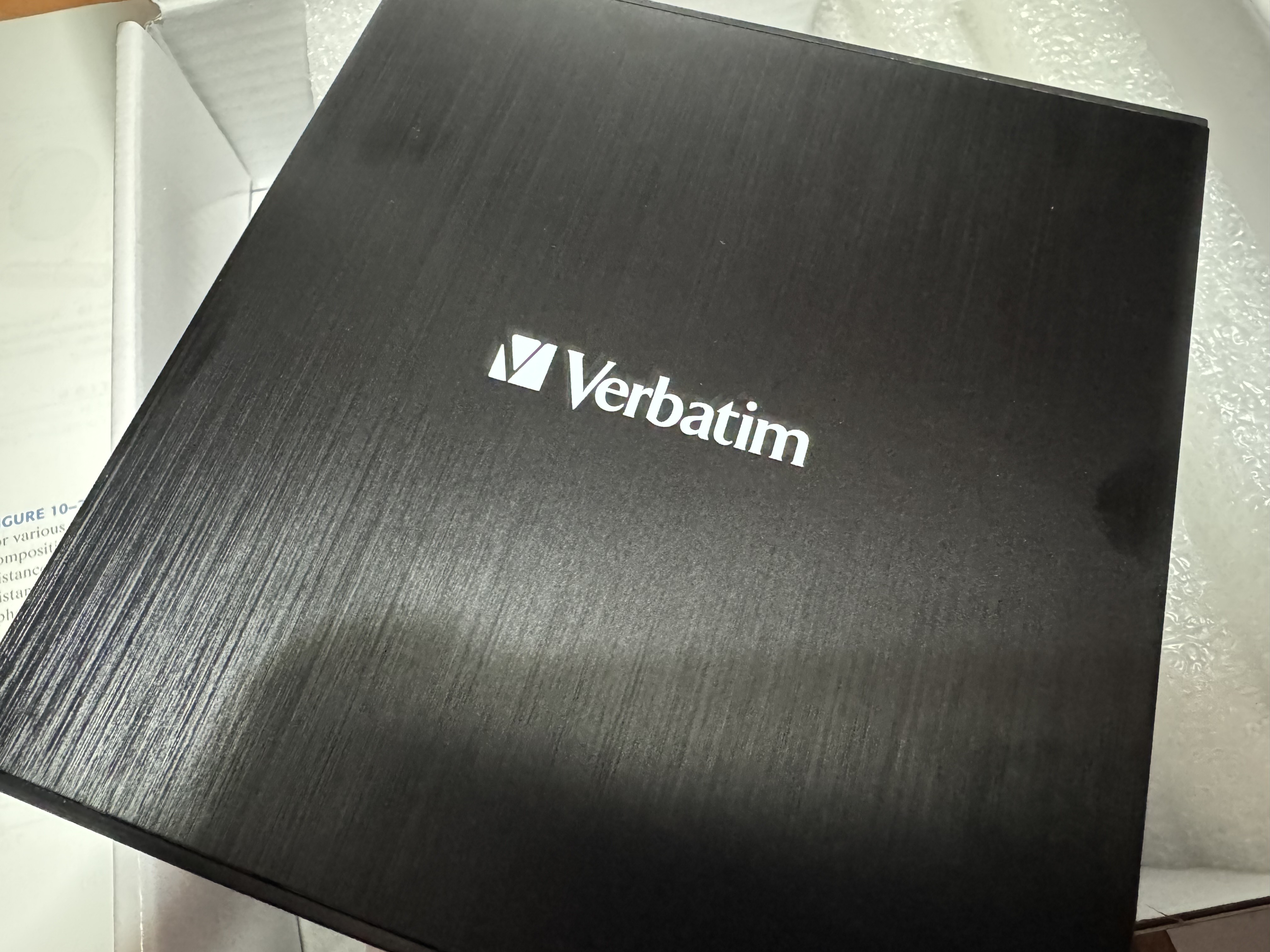

Apparently it's "hit or miss" in trying to get the Verbatim 43888 drive with the Pioneer hardware, but I just wanted to let people know that today, April 9, 2025, Amazon sent me a Verbatim drive with the following:
OS device name: F:
Product: BD-RE BU40N
Revision: 1.05
Serial number: MOFOAMA####
Highest AACS version: 76
I already have an LG and Pioneer drive but I was hoping to get another Pioneer. Oh well.

Yes, you have the BU40N. There are no more 43888's containing Pioneer drives. They are all now containing LG BU40N drives inside.
