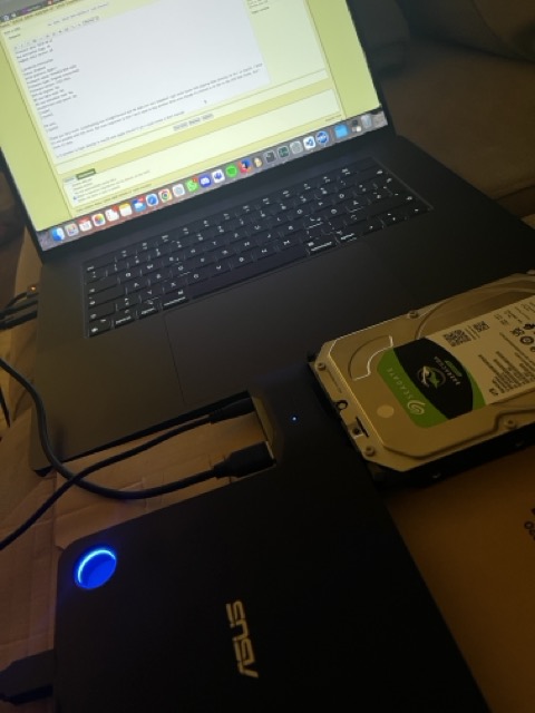

This is my portable setup lol:
224D0BFD-9473-457E-ABE8-93877D3F0430 Medium.jpeg (50.5 KiB) Viewed 41578 times
Posted: Fri Mar 14, 2025 10:20 pm
by Coopervid
The firmware files are Windows only by the author. No options therefore.
