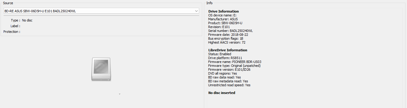

Post your drive information with a MakeMKV screen.
Gozer83
Joined: Thu Apr 03, 2025 10:09 pm
Post by Gozer83 »
Excuse me, is that better and does it help?
zittrig
Posts: 360
Post by zittrig »
Yes, that helps. The drive informations on the right are important.
Your drive can be flashed. Just wait a bit, someone (Billycar11 or Coopervid) can support you.

Gozer83
Post by Gozer83 »
Answered. Thank you very much. You guys helped me a lot.
